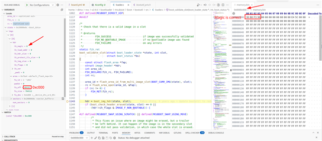

Using a debugger, I found out that the bootloader starts, but is unable to find an image. Also, for some reason, logs are disabled in the bootloader.
With a help of the nrfjprog, I have dumped the MCU's memory and inspected the dump. In the dump, I can see the image at the expected address.
So the problem is that I cannot properly set up the project for a custom board, while it works fine for a board from the SDK.
    I think I see why. In your pm_static, the bootloader pad region stops at 0xc800, while the application (mcuboot_primary) starts at 0xc000, i.e before the bootloader region (mcuboot + mcuboot pad) ends

    I am not sure, that this is the problem because:
    1. If I compile the project for the nrf54l15dk/nrf54l15/cpuapp board target everything works fine (pm_static.yml is left unchanged)
    2. Here in the SDK application the mcuboot_pad stops at 0x7800, while the mcuboot_primary
    starts at 0x7000. Which looks similar to my pm_static, but they just use smaller partition for the bootloader

  • Thanks for the link to partitioning explanation! I was searching for this.
    Have you made sure to reduce and increase any relevant gaps that occurs with the reduction of the bootloader partition?
    The only thing I changed was the boot_partition size in the board dts file (which is, I think, is unnecessary). The pm_static.yml file has all the partitions taken from the partitions.yml, as described in one of the Nordic lessons. I have done no changes to the pm_static.yml.
    I have also run Memory report tool for both targets (my custom board and the DK) and the partitions are completely identical there.
    The device sends no logs, while in Mcuboot, the logs are not even compiled (which is strange for me, because there are logs for the DK target).

  • I have managed to solve the problem with logs. Here is what the bootloader prints for my board:
    *** Booting MCUboot v2.1.0-dev-12e5ee106034 ***
    *** Using nRF Connect SDK v2.9.0-7787b2649840 ***
    *** Using Zephyr OS v3.7.99-1f8f3dc29142 ***
    I: Starting bootloader
    W: Failed reading sectors; BOOT_MAX_IMG_SECTORS=128 - too small?
    E: Image in the primary slot is not valid!
    E: Unable to find bootable image
