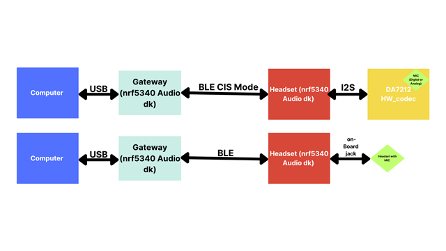

However, I am currently experiencing several issues:
  • The recorded microphone signal is accelerated, playing back faster than it was recorded.
  • The input signal quality is poor when using an analog microphone, but it improves significantly with a digital microphone.
  • When using the microphone and playing audio through the headset simultaneously, the recorded sound is barely audible (very low signal strength).
  • Occasionally, one of the DKs disconnects, causing a complete loss of audio.
Any insights into what might be causing these issues? and how might they be solved?
Thank you in advance—I truly appreciate your time and support.

  • Hi Dejan,
    Is scenario the same as shown in the picture previously, just with one headset instead of two? Which code changes (specified in your second ticket) are now relevant to gateway and headset?
    Yes, it's the same, with the same changes applied. However, as I mentioned earlier, the issue with the accelerated mic signal also occurs with the default configuration of the nRF5340 Audio DK and its original SDK code. Both scenarios are shown in the figure below.

  • Hi Abdulmohaimen,
    The issue might be related to CPU. Bidirectional communication with USB can stress CPU too much on a gateway side so that it cannot handle MIC return properly. This can lead to some packets being dropped which causes audio stream to become distorted. Potential solution could be switching to 16 KHz as default for bidirectional communication. You could try to test (make a trial) using the following latest branch
    https://github.com/rick1082/sdk-nrf/commits/cis_stereo_audio_sink_pre280/
    Please not that this is a demo branch and therefore there is no warranty or support guarantee. The code in this demo branch is provided as-is. You should do your own testing to check and verify desired functionality.

  • Hi Dejan,
    I’ve tested the demo in both scenarios, and I believe it demonstrates improved performance (especially with the initial configuration scenario, where i think that i have problem with the codec configration or maybe because of the I2S, almost because of the i2S because i tried that with Pixel Google phone and was all fine). Since I’m currently out of the office, I’ll test it again using a different headset with a digital microphone once I’m back. I plan to be there at the beginning of next week and will update you as soon as possible.
    In the meantime, I still have three remaining technical questions regarding this project:
    1. Audio Output Issues in CIS Mode
    Sometimes when using CIS mode, even though the headset and gateway appear to be connected and synchronized, I can't hear any audio output. I’ve noticed that pressing the reset button on both devices—sometimes once, sometimes multiple times—resolves the issue. Do you have any insight into what might be causing this behavior? Is there a known fix or workaround?
    2. Dual Microphone Setup on NRF5340 Audio DK
    Is it possible to use two different microphones with a single NRF5340 Audio DK headset? For my case, I need one microphone for the left channel and another for the right. As far as I know, my hardware codec supports this setup—can you confirm whether this configuration is supported?
    [EXTRA ]3. MCLK Frequency and Synchronization Issues
    What is the exact MCLK frequency that the chip provides over I²S? I tested this with two different operating systems and observed two different values. Additionally, I attempted to bypass the default MCLK and provide an external 12.288 MHz MCLK (as suggested in other DevZone tickets). However, this led to synchronization issues—one board's LED remained off and no audio was output. Could you clarify the expected MCLK configuration and whether external clocking is supported and stable?
    Once again, I want to sincerely thank you for your time, effort, and support. We’re getting very close to resolving all potential issues, and I truly appreciate your continued support.

  • Hi Abdulmohaimen,
    We are not able to see this situation on our end. Can this issue be replicated using nrf5340_audio-dk? Could you please share the log and point out the timing when the issue appears?
    In our demo branch, we only send single MIC stream and decode one MIC stream on the gateway side. Current audio project does not support what you try to achieve, but you can try to further study application and modify it yourself.
    Did you configure nRF5340 as I2S slave? Do you want to ignore MCLK from nRF5340 and use another clock source?
    Since it is nrf5340 that needs to tune I2S clock speed to sync with BLE activity, it is important to use nrf5340 as I2S master and let nrf5340 handle the clock system.

  • Hi Dejan,
    Since the latest edit you provided works better with the initial conditiond of nrf5340audio dk, and before continuing with the other potentials. I'd first like to confirm everything with my MCLK before proceeding further.
    I'm using the nRF5340 in master mode, where it provides the MCLK to my external hardware codec. I tried measuring the MCLK using two different oscilloscopes, but I got two different values: 3.471 MHz and 6.14386 MHz. And for both:
    • BCLK: 1.536 MHz
    • WCLK: 48,000 Hz
    What are the actual frequencies of the Master Clock (MCLK), Bit Clock (BCLK), and Word Clock (WCLK) generated by the nRF5340 Audio DK via the I²S interface?
    I also tried enabling the Bypass mode in audio_i2s.c to generate a 12.288 MHz MCLK.

    how is it possible to solve this?
    Thanks in advance!
    Abdulmohaimen
  • Hey Dejan,
    is there ny news? Looking foewaed for your support.
    Thanks in advance!
    Abdulmohaimen
  • Hi Abdulmohaimen,
    You could try to check settings on the codec side.
    I expect to get back to you with additional information by the end of next week.
    Dejan
  • Hi Abdulmohaimen,
    MCLK value should be close to 6.144 MHz. With currently used ratio of 128 and ratio * LRCK = MCLK (see LRCK in the documentation), MCLK is expected to be 6.144 MHz. You could try to check on the oscilloscope using higher sampling rate (more than twice of 6.144 MHz).
    As for bypass mode, it is expected for MCLK to be 12.288 MHz. It might be that your codec is not configured properly. You can check your codec settings.
    Dejan
  • Hi Dejan,
    Thank you very much for all the support you provided in this ticket. I’ve decided to continue using I²S as the source for my signal, where the USB configuration still shows the accelerated mic signal.
    I do have one remaining question:
    Is it possible to reduce the frequency of the source in the uncast_client.c file,
    #define BT_BAP_LC3_UNICAST_PRESET_STEREO_16_2_1(_loc, _stream_context)                                    \
     	BT_BAP_LC3_PRESET(BT_AUDIO_CODEC_LC3_CONFIG(BT_AUDIO_CODEC_CFG_FREQ_24KHZ,                 \
     						    BT_AUDIO_CODEC_CFG_DURATION_10, _loc, 40U, 1,  \
     						    _stream_context),                              \
     			  BT_AUDIO_CODEC_QOS_UNFRAMED(10000u, 80u, 2u, 10u, 40000u))
    static struct bt_bap_lc3_preset lc3_preset_sink = BT_BAP_LC3_UNICAST_PRESET_NRF5340_AUDIO_SINK;
    static struct bt_bap_lc3_preset lc3_preset_sink_48_4_1 = BT_BAP_LC3_UNICAST_PRESET_48_4_1(
    	BT_AUDIO_LOCATION_ANY, (BT_AUDIO_CONTEXT_TYPE_UNSPECIFIED));
    static struct bt_bap_lc3_preset lc3_preset_sink_24_2_1 = BT_BAP_LC3_UNICAST_PRESET_24_2_1(
    static struct bt_bap_lc3_preset lc3_preset_sink_16_2_1 = BT_BAP_LC3_UNICAST_PRESET_STEREO_16_2_1(
    static struct bt_bap_lc3_preset lc3_preset_source = BT_BAP_LC3_UNICAST_PRESET_NRF5340_AUDIO_SOURCE;
    static struct bt_bap_lc3_preset lc3_preset_source_48_4_1 =
    	BT_BAP_LC3_UNICAST_PRESET_48_4_1(BT_AUDIO_LOCATION_ANY, BT_AUDIO_CONTEXT_TYPE_UNSPECIFIED);
    static struct bt_bap_lc3_preset lc3_preset_source_24_2_1 =
    	BT_BAP_LC3_UNICAST_PRESET_24_2_1(BT_AUDIO_LOCATION_ANY, BT_AUDIO_CONTEXT_TYPE_UNSPECIFIED);
    static struct bt_bap_lc3_preset lc3_preset_source_16_2_1 =
    	BT_BAP_LC3_UNICAST_PRESET_16_2_1(BT_AUDIO_LOCATION_ANY, BT_AUDIO_CONTEXT_TYPE_UNSPECIFIED);
    similar to how it was reduced to 16 kHz on the sink side? I attempted to configure this myself, but I wasn’t able to do it correctly. Would reducing the frequency on the source side help reduce CPU load and possibly improve signal quality?
    Otherwise, I’ll go ahead and close this ticket and open a new one regarding the use of dual microphones in different setups.
    Thanks again for your support!
    Abdulmohaimen Algamoudi
  • Hi Abdulmohaimen,
    Could this discussion be helpful?
    CPU rate is directly impacted by the sampling rate. USB audio interface and bidirectional communication require CPU resources. To avoid getting CPU overloaded and having bad audio quality, you should consider using either 16 KHz sampling rate or mono channel instead of stereo.
    Dejan
