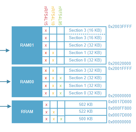

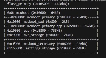

Working on the 54L15 and curious about the relationship between the memory map and partition example.
From multiple examples, the partition ends at 0x165000, such as:
 While, when I read the datasheet, the memory map ends at 0x17D000. The difference is about 92K.
Why does the partition stop at 0x165000 if the chip has more space?  Will it cause any issue if I allocate those memory into the partition map?
