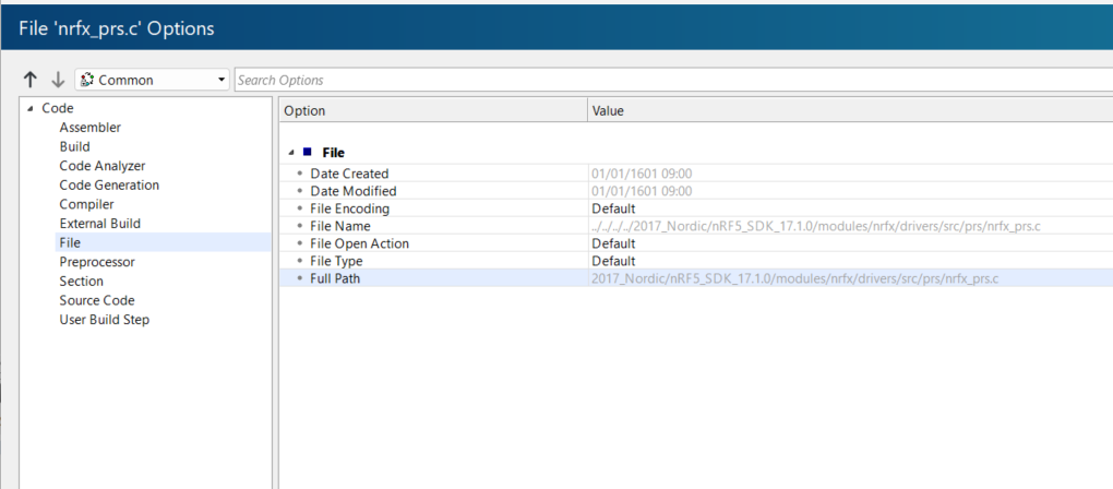

Corresponding C file - right mouse - option - file - full path
(The C file with the error has an abnormal path.)
So, I try to chang.e the full path to the normal path, but it cannot be modified because it is deactivated.

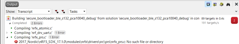

    I followed your advice and moved the folder right to D: to shorten the path.
    And when I build, the same error as below occurs.
    However, the file path in the error window is not the path I moved to.
    (Folder on the PC where the original was created before copying)

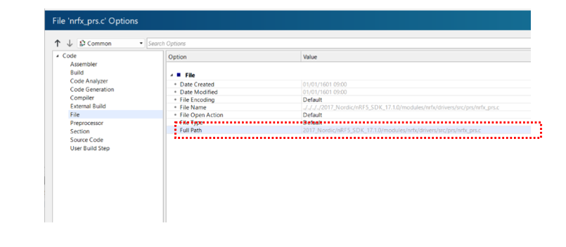

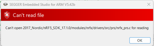

    I tried opening 'nrfx_pars.c' where the error occurred... but the file did not open.
    (This is the PC path before the previous copy.)
    If you look at the options for the file, the file path is incorrect and cannot be modified.
    However, if you look for it, there are many files that cannot be opened as shown above.
    So I would like to know how to fix incorrect paths in bulk.
