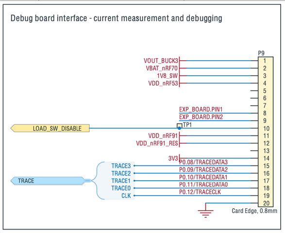

I was looking into PCA64165_Schematic_And_PCB.pdf and PCA20065_Schematic_And_PCB.pdf of Thingy91_X - Hardware files 1_0_0.

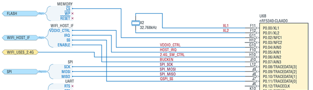

Below image shows the nRF9151 pins in red and nRF5340 pins in black.
According to below image, it should be P0.08 to P0.12 for nRF5340, which matches to the above stating TRACE xxx.
What confuses me is that P0.08 to P0.11 are used for SPI.
SPI is shared with nRF9151 yet on other pins for the nRF9151 that connected to the debug board.
These drawings are very confusing for me. Can you please confirm the pins?
Side questions: What is the meaning of the two different shadings of red?

  • My assumption is that the PIN numbers on "Debug board interface - current measurement and debugging" are a mistake. The PIN numbers for TRACE of the nRF9151 should be written there. And that the only PINs from nRF5340 are the shared I2C.
  • I got it working using pin P0.30. I saw that the TRACE of nRF9151 is connected to GPIO, which are connected to P0.30 - P1.01 of nRF5340.
    Given my interpretation is correct, I would suggest to

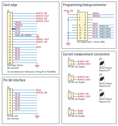

    • fix the labels on "Debug board interface - current measurement and debugging" of PCA20065_Schematic_And_PCB.pdf
    • fix the labels on "Figure 30: Current measurement and debug board connector" of Thingy91X_UG_1.0.0.pdf
    • add an entry to Thingy91X_UG_1.0.0.pdf explaining which PINs are available on the debug connector board for each mcu
