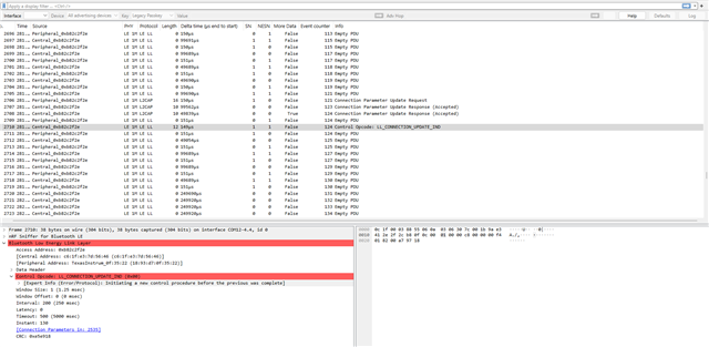

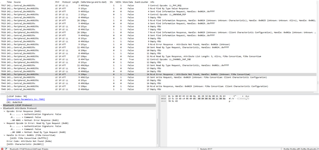

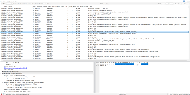

               thank you for the mail, i tried to use sniffer to capture the events during the error reason 62 using nrf dongle. since I'm a new to the controller, I'm not sure how to identity the issue looking into the log. i'm not sure how to add the log file in the chat since there is no option to add a file i'm providing the snap of the log.

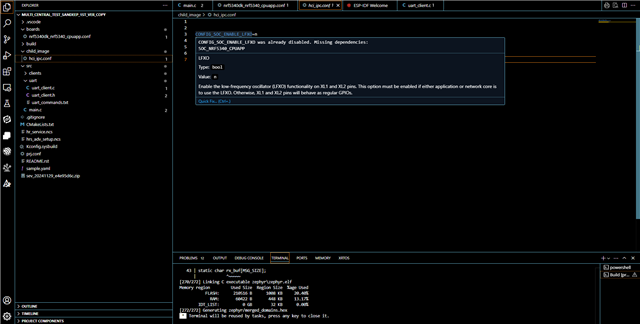

    Moreover i tried to add the config bit to enable internal RC as per the example you have mentioned in added the config file under the directory child and also have added a folder called boards and added nrf5340dk_nrf5340_cpuapp.conf as well but still i get the error 62 and i gets a warning as CONFIG_SOC_ENABLE_LFXO was already disabled. Missing dependencies:
    SOC_NRF5340_CPUAPP can u plz tel what is difference between using conifg file in board folder , child folder and directly in the project as .confg file
  • All three pictures show a central in a connection with a peripheral device but I don't know which devices these are. The capture should include the failing case where your central is sending the connect ind packet but failing to establish the connection. What happens when you try to upload the capture files?
