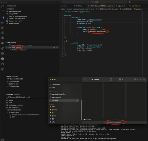

overlay
 * Copyright (c) 2019 Peter Bigot Consulting, LLC
/delete-node/ &storage_partition;
&mx25r64 {
	partitions {
		#address-cells = <1>;
		#size-cells = <1>;
		storage_partition: partition@0 {
			label = "storage";
			reg = <0x00000000 0x00020000>;
	msc_disk0 {
		compatible = "zephyr,flash-disk";
		partition = <&storage_partition>;
		disk-name = "NAND";
		cache-size = <4096>;

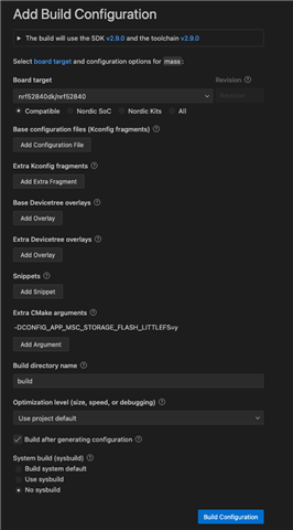

    How did you build the sample? The sample only works without sysbuild (so either check the "No sysbuild" radio button at the bottom when making a build configuration in VS Code, or use --no-sysbuild if building with west direclty from the command line.
    Also, you need to specify the storage as explained in the sample documentation.
    Here is an example configuration from VS Code:
    Regarding specifying the storage, I believe what I have already set with
    CONFIG_APP_MSC_STORAGE_FLASH_FATFS=y
    should be sufficient.
    As for compiling without sysbuild (since it is not mentioned on the example page), this indeed solves the compilation issue. However, I would like to ask: how can I use MSC with sysbuild, considering that it is expected to be the default in the future?
