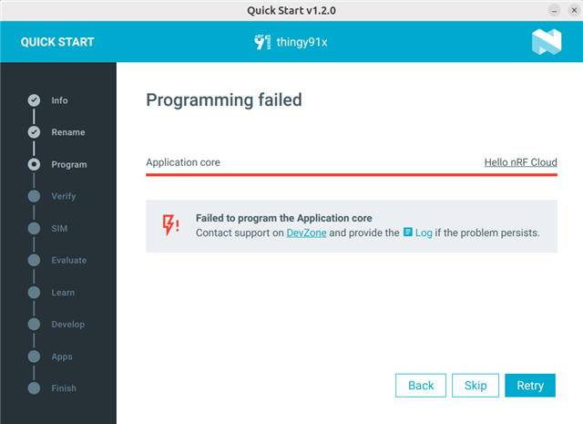

  • I'm not sure how much of this is related but some connectivity_bridge issues I've encountered with Thingy:91X.
    It was good to see at least connectivity_bridge v290 working for t91x in VS since the nordic issued hex would no longer flash for me in programmer.
    Without connectivity_bridge, problematic to add a new certificate.

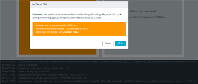

    Sometimes necessary to recover t91x when trying to flash t91x in VS.
    After flashing t91x from VS a few times, then MCU boot issues crop up when trying to flash t91x a hex in programmer or quick start. Yet still ok flashing from VS through nrf9160dk.
    Here trying a basic hello_nrfcloud (and same when trying connectivity_bridge).
    but this issue is for another case, and maybe not this one.
    thank-you,
  • This is likely not the exact same issue but thanks for posting.
    Feel free to create a new ticket, and you can link to this ticket as well in there as there might be som overlap in the issue.
    Also share the logs from the quickstart guide as well.
