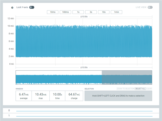

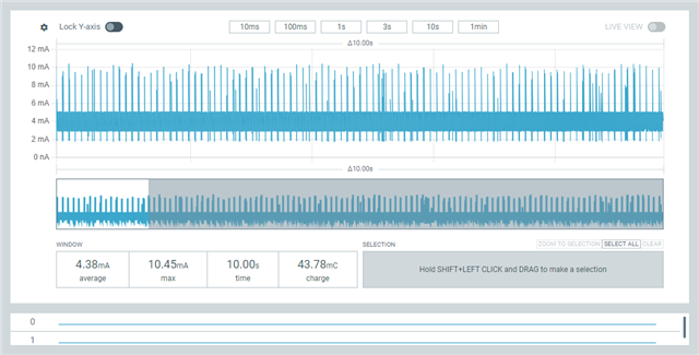

  • The CPU is running at 64MHz with a 32MHz crystal.
    When everything is streaming, we are running the ADC at 132kSps scanning over 4 channels, manipulating the data some, then packing the data into the payload of the BT packet.  The BT is running at 2Mbps transmitting (streaming) at 0dBm.
    If you mean PPK is the Power Profiler, I do have some logs.
    Before streaming, 3.9V input, avg current is 4.4mA
    During streaming, 3.9V input, avg. current 6.5mA avg.
  • This is a little complicated to go about.
    First of all, the PPK has a limitation where if the voltage cross between two of its measurement ranges, the measured value is overshot a lot, creating a false spike. This affects our ability to evaluate the maximum current with it.
    Next, to tell what happen in a PPK log, you will need to know the application at even higher level of detail.
