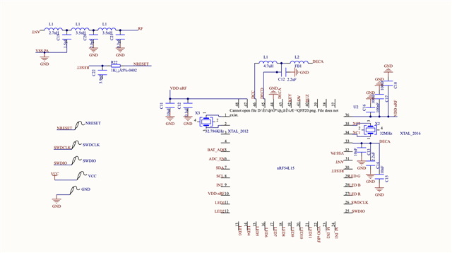

Hi, I would like to have some suggestions on my PCBA design for nrf54L15 chip. Please review it and give some suggestion moving forward. I am making this PCB to use this with matter-over-thread products. Since nrf54L15 is a pretty new product, I couldn't find many reference designs online. I mostly used the reference designs provided by Nordic but have been struggle on the programming port design. Also does nordic have any recommendation on which Antenna I should use for this design?

  • Hi Eric,
    I have reviewed the design. Just remember that
    • "For the device to function properly, exposed die pad (pin 49) must be connected to ground (VSS, pins 32 and 44)".
    For programming external boards using the nRF54L15 DK's debug port, the external board must:
    Please let us know if you have any specific questions regarding programming the board.
    The rest of the design looks good.
    Choosing the optimal antenna depends higly on the type of application, budget and available board space.
    • Monopole quarter wave PCB antenna: This is easy to make and tune, requiring only one shunt component for impedance matching plus the antenna length. It needs about 23 mm of space and a minimum 5 mm clearance to the ground plane. This is a good option if you have sufficient board space. Make the antenna a little longer than required and cut it shorter  on the prototype when tuning it. See General PCB design guidelines for nRF52 series.
    • Off-the-shelf chip antennas: There are many chip antennas available that work well with Nordic devices. These are particularly useful for size-constrained designs. When selecting a chip antenna, pay close attention to the recommended mounting instructions from the antenna vendor. Check out our reference designs Thingy:91/9X/53 for some examples.
    Nordic offers hardware reviews and tuning of the radio matching network and the antenna. Just create a private ticket on DevZone.
    Also see nWP_017 - Antenna tuning.

    Thanks for reviewing our PCB design! We have made the following changes.
    1. Make a 10-Pin SWD header
    2. Use a Monopole quarter wave PCB antenna
    Could you review our PCB layout and give some suggestions? We are especially worried about the Antenna performance. If you could provide some guidance in that front, that will be of great help.
    Thanks
    Eric

    Schematic review
    • Antenna matching components are missing. For a trace antenna, it is common to use one shunt component. Place the component close to where the trace antenna leaves the ground plane. Some designers use a Pi-network, however, one components could be enough.

    • Why is there no ground below U2? Have you doubled checked with the documentation or component manufacturer that this is recommended? You could in any case try to ask the manufacturer for a review.
