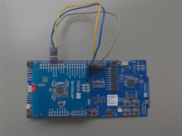

We are trying to max out the wifi throughput via nRF7002 when connected to SPI4. Currently we only achieve around 6.3Mbits/sec (TCP Upload to peer).
When measuring the SPI4 CLK we only see 16Mhz despite configuring 32Mhz in app overlay.
Question: What can we do to configure SPI4 for 32Mhz? Will this lead to higher throughput?
Hardware:
  • nRF5340-DK
  • nRF7002-EK
    • Modifikations: CLK, MISO and MOSI pins are connected to P0.08, P0.10 and P0.09

  • Hi Moritz,
    I observed the same results as you. I suspect this could be due to long wiring causing the SPI timing requirements to not be met.
    We have had customers successfully use SPI4 at 32MHz on their custom boards before. I will spend more time investigating this next week and update you accordingly.
    Charlie
