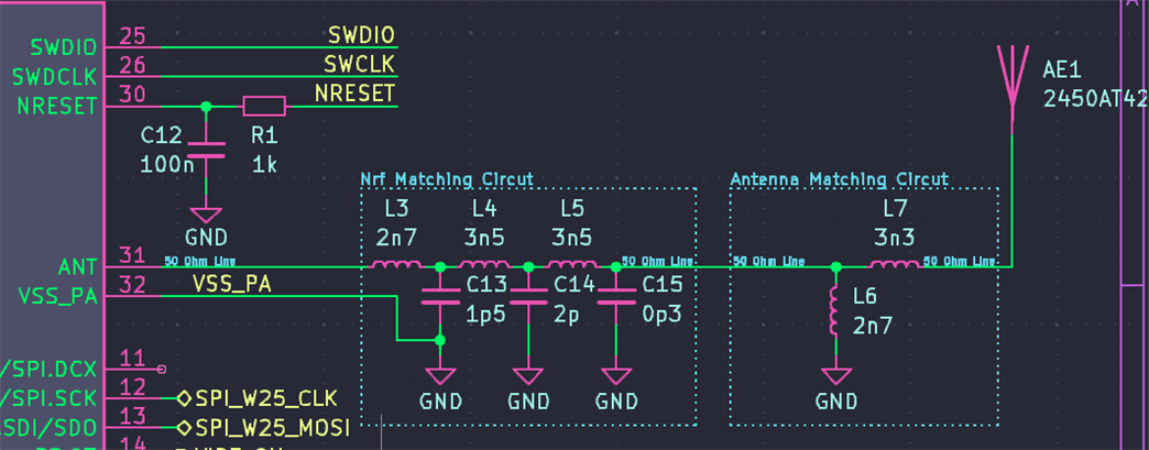

This is my first time designing RF section for BLE using nRF54l15, and i was wondering if you guys can give me some feedback on hardware design. I chose a Johanson 2450AT42B100 chip antenna to save more space as board have strict dimension constraints. I used 0.157mm trace width for 50ohm line. I got this value from pcb supplier. I used matching networks from nRF and anetnna documentation and it looks like this:

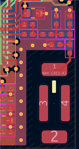

PCB Layout:
I connected C13 gnd pad to nRF pin 32. Rest of gnd connections are made to bottom layer through vias.

    Schematic wise this looks good, but the layout is far from optimal.
    • There should be ground on either side of the radio matching network on the top layer.
    • No traces can be run directly under the RF path, a internal layer must be used for shielding any traces that needs to be routed under the RF components.
      The traces on the second layer can be moved to the bottom layer, and the ground fill on the 3rd layer extended to under the RF components. If this is done the grounding of C14 must be only connected to the 3rd layer.
    • The antenna is designed to have a 1mm gap to the top layer ground fill:
      It may not perform as expected if the mounting recommendations from the antenna datasheet isn't followed.
      There must also not be any ground under the antenna keepout area, so the bottom layer needs a keepout area.
    Bendik
    Thanks for your time. Im not sure about last sentence, because the antenna datasheet points to yellow area as Ground/metal clearance. I think it is meant to be interpreted as keepout on the top layer and ground on bottom layer.
    Sorry about the delay.
    Most chip antennas require keep out areas on all layers, the ones that needs GND on beneath them will specify it in the datasheet. A example of this type of antenna is the 2450AT42E010B001E, where the datasheet specifies that no antenna ground clearance is required on the bottom layer:
  • This is the desing that went into a prototype:
    1. Ground on the top layer of the matching network, but not on the either side due to size constrains
    2. No traces under the antenna or matching circut
    3.C14 connected directly to the bottom ground
    4. No ground under the antenna and as much keep-out as possible on the top layer
    The BLE connection works, but i do get occasional connection drops. The Nordic app is showing a RSSI of around -75dbm at 100mm. Is it underperforming and needs some hardware changes? Thanks for help.

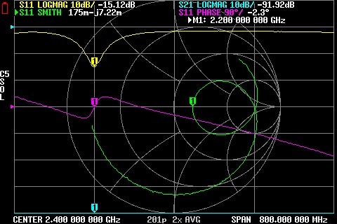

    We were able to use LiteVNA connected to the input of the matching network, and capture the following data:
    Should we try to achieve a resonance dead on 2,4 GHz?
  • The closer to 50 ohm the better but you don't need to be super accurate here. But check how the housing affects the antenna. Some types of plastic may affect the antenna. And metal of course.
