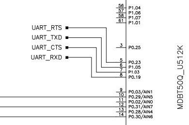

Hello everyone,
I trying to configure my MDBT50Q-U512k to use the ble_app_nus example. According to my board, I need change to uart pins defined in this example. Then, I have problems to configure it. My schematic is:
and the defult uart_init funcion is:

but to my code I modified according to my schematic, but the tx pin doesn't work.

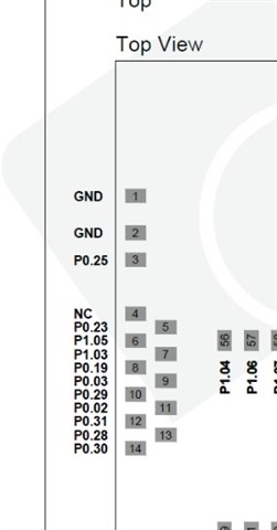

I developed according to datasheet (see top view pins below)

    Agree with Hugh. You need to use NRF_GPIO_PIN_MAP(port, pin). See:
     #define NRF_GPIO_PIN_MAP(port, pin) (((port) << 5) | ((pin) & 0x1F))
  • Sorry for delay, but it works now.
    my solution for this case:
    #define PINO_TX NRF_GPIO_PIN_MAP(1,5)
    #define PINO_RX NRF_GPIO_PIN_MAP(0,19)
