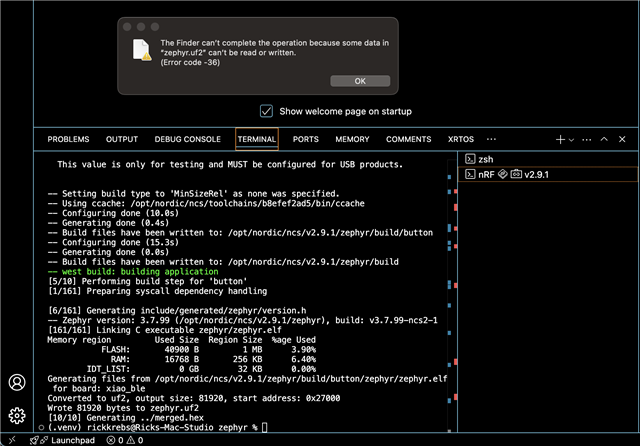

I used the nRF Connect "blinky" sample to create the skeleton build configuration for the Xiao Sense and of course this compiled, assembled, linked, and executed as expected.  Per multiple tutorials I simply copy the .uf2 file to the Xiao Sense to flash it to the nrf52840.  I kept this Blink/LED code in the program to have evidence that the program flashed correctly.
To build the SD functionality I used the fat_fs.c code from the most recent nRF Connect sample and incorporated it into the "blinky" sample (see attached file).   I would like to try to access the SD card through SPI (using the disk driver API with the SDMMC subsystem working transparently underneath).

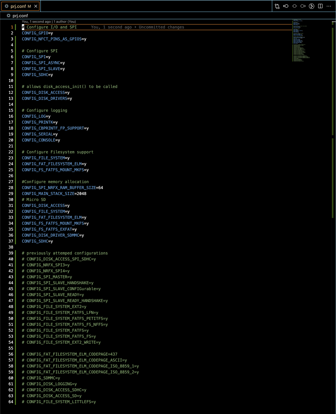

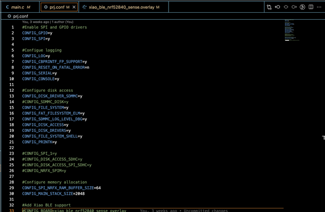

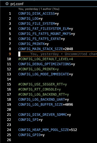

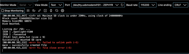

However, when I flash this revised code I receive an error at the if (disk_access_init(disk_pdrv) != 0) {...} system call:
I have tried multiple configurations to solve the problem.
1. rechecked connections and power including that the microSD card is inserted into the SD card slot at all times/power stable to device/card throughout process as this is an fat system
2. tried suggestions from several nRF Connect Forum posts including this one without luck: https://devzone.nordicsemi.com/f/nordic-q-a/109575/xiao-ble-sense-round-display---zephyr-microsd
3. contacted the OP of the post from 2. as they report having resolved an identical (?) issue but I have not received a response

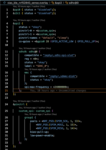

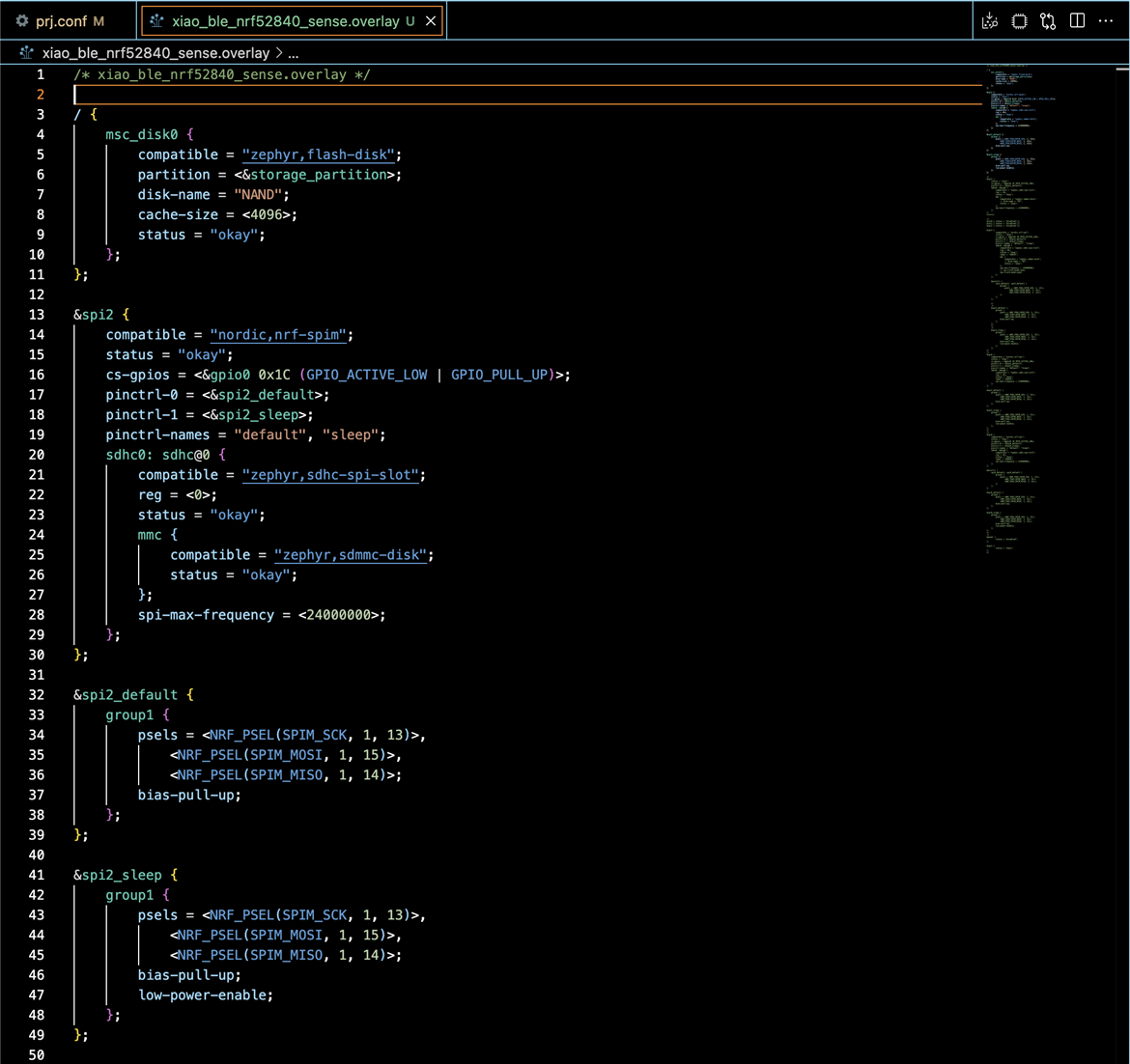

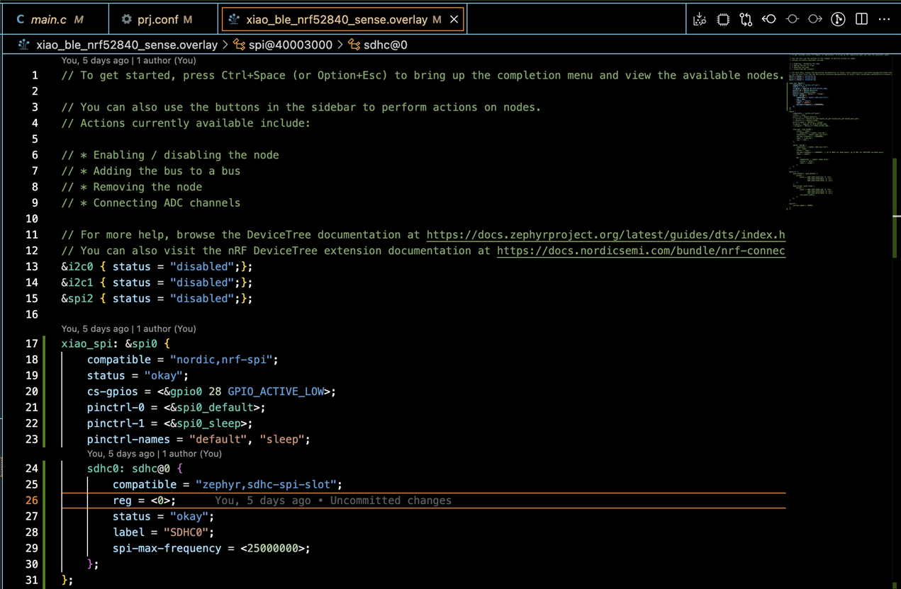

4. in prj.conf I have tried all 4 SPI interfaces (SPI0 through SPI3) though I am under the impression that SPI0 and SPI3 are preferred for SPI (note I am currently using SPI2 but I have received the same error mentioned above in initializing the SD card using all 4 interfaces.
5. I have added the "zephyr,sdmmc-disk" device tree node to each of the SPI interfaces to no avail
6. Adding CONFIG_NFCT_PINS_AS_GPIOS=y to prj.conf but this did not affect the error (got same error)
7. Seeed Studio (maker of Xiao board) Forum has not been helpful (extensive search through posts)
8. tried various filesystems (by enabled in prf.conf) including ext2 and littlefs but there does not seem to be a way to do this at this point
9. considered using NVMe but trying to use PCIe would seem to complicate this situation more
10. considered emulated block device of flash partition support (I assume this means the 2 MB onboard nRF25840 SoC flash) but I need to record/write to SD at least 3 MB of data (approximately 3 minutes of audio data) so this does not seem adequate (though it would be very cool to know how to do this).  Of note, I did retain the msc_disk0 device note information (from here: https://docs.nordicsemi.com/bundle/ncs-2.4.3/page/zephyr/services/storage/disk/access.html#disk-access-api) in my overlay file but I am assuming this should not interfere with the spi2 DT configuration.
My related questions are:
* how does the SD host controller figure into this process and am I missing something in the configuration to enable this?
* how to use direct block level access (meaning using DMA?) to the SD card/is this possible as an alternative to using SPI?
* do I need to make changes to yaml and/or .json files in order to enable SD functionality for this board and/or create custom board support for the Xiao?

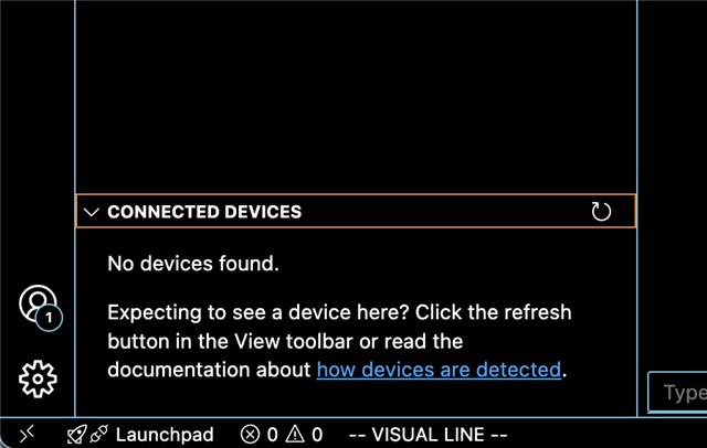

  • Thank you for your response Sigurd, I appreciate it.  What you say makes sense.
    I did just try to flash the two examples mentioned for the Xiao Expansion Board (the LED button example at samples/basic/button) and LVGL basic example (at samples/subsys/display/lvgl) and they build without error.
    But when I copy the .uf2 file to the Xiao Sense I do not see any response or output on the board (no response to button press and no display in the lvgl sample case).
    And the Xiao board is unmounted when the .uf2 file is flashed so I cannot use the terminal monitor to check any output.
    Here is the output from the button sample build.
    I dragged the small screen of the output from the .uf2 file copy into the VS Code output screenshot above to show the response that always comes up, that "Finder can't complete the operation because some data in the "zephyr.uf2" can't be read or written".
    I have not been too concerned about this but I do wonder if this is an issue or could be an issue.  I have Segger JLink and associated libraries, etc. installed (and up to date) but this is a known issue I think that the VS Code cannot locate the Xiao (and perhaps other boards) under Connected Devices.
    For this reason I cannot use $ west flash (after building the .hex file)
