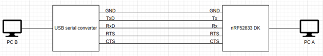

I'm using the nRF52833 DK to communicate with another device and I noticed that I can send data from the nRF to the other device, however, I can't send data from the device to the nRF.
I decided to test with an example from Nordic (UART echo bot) and noticed that when I use the default pins of the UART, the communication works as it should (nRF <-> device). However, when I switch to the pins I'm using in the main project, communication only works in one direction (nRF -> device), i.e. there's no more communication (nrf <- device).
These are the pins I'm using:

    Regarding the output, I don't have nothing that can help. But I can try to explain the problem better.
    I have a USB serial converter connected to a PC with hterm (PC B). And a nRF52833 DK connected to other PC with nRF Connec for VS Code (PC A).
    Using the default UART pins of the nRF52833 DK, I send “test1” via VCOM0 from PC A to PC B and the data appears in PC B hterm. Then, for example, I send “test1_ans” via PC B hterm and this data appears on PC A.
    When I change the pins to those described above, I send “test1” via VCOM0 from PC A to PC B and the data appears in PC B hterm. However, when I send “test1_ans” via PC B hterm, this data does not appear on PC A.
    Thank you
    Pins P0.06 and P0.08 are specifically used by the interface MCU for UART communication. source: Virtual serial port
    When you're trying to use these pins for external communication (to your USB serial converter), they're already being used by the interface MCU for the virtual COM port. I guess for this reason, it does not work from PC B to PC A through external USB serial converter.
    Can try to change your UART pins to avoid using P0.06 and P0.08, which are already used by the interface MCU?

    It could be a side effect on the new boards that use the nRF5340 as the interface chip, versus older boards that used third-party IC for this. The solution is to use different GPIO pins that are not used by the interface chip as I said before as well.
  • To make work UART correctly on SDK >= 2.8.0, you should add this to your prj.conf :
    # (to make uart work on sdk >= 2.8.0)
    CONFIG_UART_NRFX_UARTE_LEGACY_SHIM=n
