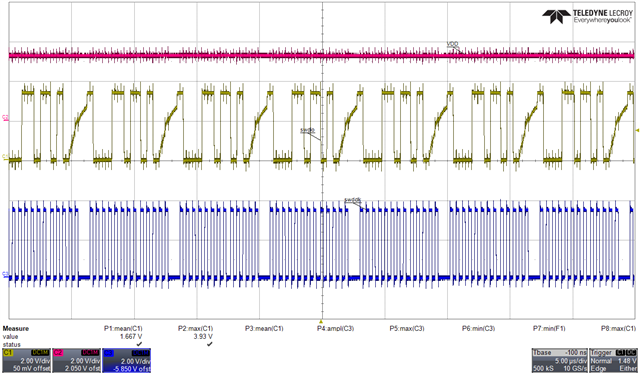

    The low power warning is confusing in all of this. That is the warning when the reference voltage is not there or lower than 3.3V. But you say you measure 3.3V on VDD; VDD_GPIO and VDD_Ref. The SWDIO and SWDCLK pins are they toggling as expected? Are you able to capture with an oscilloscope?
    Q2: See above, are the pins toggling as expected and same as on the failing devices as on the functional ones?
    Q3: Bad soldering could explain this, absolutely, that's why I'm curious if there's actually signal toggling on the SWDIO/SWDCLK pins? Are the lack of solder and porous occuring on the same pins or same area of the SIP? Are the ones with pin14 (VDD) the ones that gives the error message of low voltage? Are they also showing VDD=3.3V?

  • Hi, VDD=3.3V should be fine. SWDIO and SWDCLK are toggling. I am wondering why my current consumption is higher than in "normal" mode.
    Normal Mode (when programming is posible)= 5mA
    Problem mode (when programming is not possible) = 25mA.
