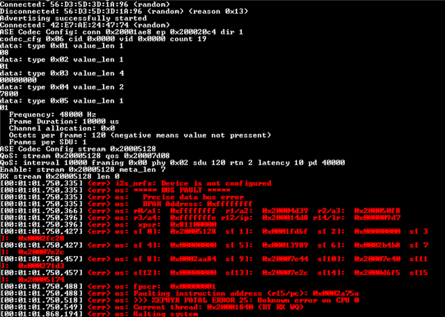

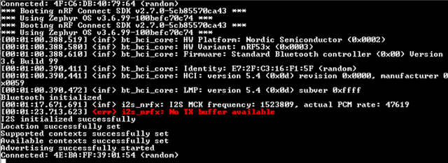

with these changes I am able to build and flash the code to the nRF5340 Dk.  I am able to connect with the mobile device with the DK as a audio device, but i have faced some errors at the starting. The errors are also attached.
Ignoring the first error I connected the device and when I played  audio in the source , the error in the below screenshot happened causing the system halt.
I understand the errors happened due to some memory buffer issues. But couldn't able to point out the exact point.
  • First error is because you try to start I²S TX without a prefilled buffer. You needed to call i2s_write(...) first - the peripherial needs at least some data to send out.
    Second error is probably due to the i2s_buf_read() function call, which does not at all do what you may think it does. Also it could be a stack buffer overflow with how you use the tx_block variable that can only hold 4 bytes.

  • I have made some changes and still while playing an audio from the mobile device the system went to a system halt state. the error is attached.

    I have gone through this . I understand that LC3 is required for the unicast audio server . As I mentioned earlier the errors are still there. I am using  Samsung S23 as the audio source. While connecting with the DK it is identified as a Audio device by the mobile phone . But checking the Available Codec in the mobile  developer option not seen the LC3 codec. I am using the same code snippet shared before for the Tx of I2S.

    Do you see any change if you increase Tx queue length from default value 4? For example, you could set value CONFIG_I2S_NRFX_TX_BLOCK_COUNT=10. Does this make any difference in the output?
