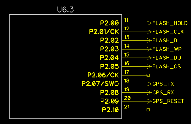

Hello and thank you for your time,
We have created a board using the nRF54l15 and have used P2.07 & P2.08 for UARTE21 and P2.00 to P2.05 for SPIM20.
UARTE21 and SPIM20 do not work on P2 thus far.
I have used UARTE00 and SPIM00, separately due to resource sharing issues, and both work with their separate devices, notably altering the current-speed to 1/8 normal.
The pin selection on P2 is dedicated and this is accounted for and shown to be correct on our board due to the UARTE00 and SPIM00 working with the devices.
The data sheets for the nRF54l15 "SEEM" to indicate that UART20/21 and SPIM20/21 can be used on P2, cross power domain, but I have not been able to get this to work properly and have found no examples showing this working.

    - do UART20/21 and SPIM20/21 work on P2 as indicated in the data sheet?
    Yes, but you can only use the dedicated pins specified in pin assignment table (e.g. P2.07 for UARTE21 RX, P2.08 for UARTE21 TX). Also note that you need to enable Constant Latency mode when using pins on P2. This can be done as mentioned in the ticket you linked, or to force it on at all times, you can set CONFIG_SOC_NRF_FORCE_CONSTLAT=y in your prj.conf file.
    - are the rates normal for UART20/21 and SPIM20/21 on P2 or are they also multiplied by 8?
    The rates are normal. The clock source is related to the instance itself and not which pins you have connected the peripheral to.

  • Thank you for the response, sorry for the late reply
    I have been working through this to try and figure out what the tripping point is and it seems to be a difference in the secure vs non-secure builds.
    Through a lot of trial and error I was able to prove this out.
    Your code, whose crux is adding:
    in order to utilize cross-power 20/21 on P2
    This code works in the secure code, aka, no Trustzone code. It fails when used in a non-secure(ns) build.
    perhaps there is setting that needs to be adjusted that I am missing?
    This is easy to recreate with your code, simply unzip your base, and create a secure and non-secure build, you will have to add the overlay for the ns build, and then test each build.
    I hope there is a fix or setting that resolves this.
    This occurs on the nRF54l15DK ENGB chipset
