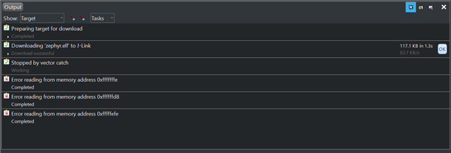

  • Follow up:
    When I manually cleared the flash of the nRF5340DK and confirmed the memory was erased using Programmer, I then flashed a new program on the new PC and encountered the following issue in Segger debug mode:
    As supplementary information, hoping to serve as clues for troubleshooting the issue.

  • Thank you. I apologize for my late reply.
    This is the return:
    C:\nrf53_project\nfr5340_sdk_1.9.1_workbench>nrfjprog --program build_nrf5340dk_nrf5340_cpuapp\zephyr\zephyr.hex --verify --sectorerase
    [ #################### ]   3.879s | Erase file - Done erasing
    [ #################### ]   0.807s | Program file - Done programming
    [ #################### ]   0.808s | Verify file - Done verifying
    I checked the version of JLink, which is different. The old PC was using V7.58b while the new PC is using V7.94i. But after I reinstalled the JLink V7.58b on my new PC, the problem still remains.
