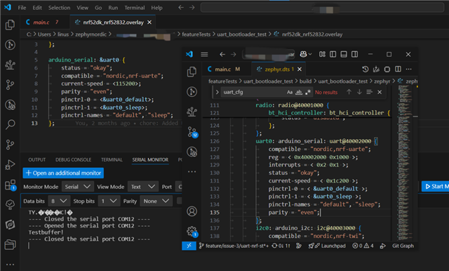

I tried to get a UART Transmission with even parity working on a nRF52832, but even if the config I write in the overlay file also is built into the zephyr.dts from the build folder, it doesn't seem to transfer the UART messages with an even parity afterwards (I'm using Async API as recommended in the DevAcademy chapter for UART communication).
The baudrate is easily changeable and is also changed on electrical level, but the parity doesn't seem to care of my configuration.
You can have a look at the following screenshot, where only with "Parity: None" the "Testbuffer!" print is readable.

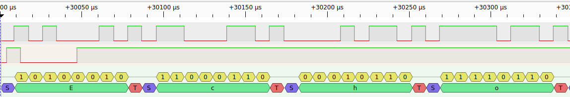

    With CONFIG_UART_0_NRF_PARITY_BIT=n the initial output ("Echo") from the echo_bot example looks like this:

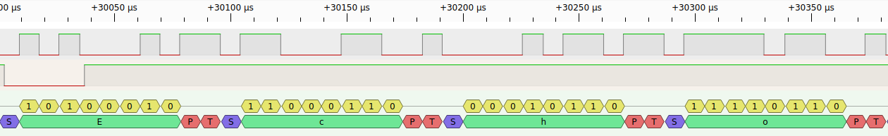

    By setting CONFIG_UART_0_NRF_PARITY_BIT=y we can see the parity bit:

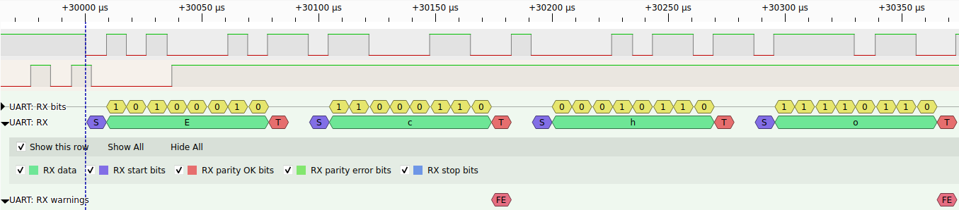

    parity="even", CONFIG_UART_0_NRF_PARITY_BIT=y, decoder is not expecting parity bits
    The decoder reports frame errors because the stop bits are not as expected. However, if we choose to ignore that, we can still actually read the data. This is probably what many USB to serial adapters do.
    By telling the decoder that there is a parity bit, it gets happier:
    parity="even", CONFIG_UART_0_NRF_PARITY_BIT=y, decoder correctly configured
    It seems that it does not matter what I set the parity setting to in the overlay file. It seems like Even parity is used for transmission when CONFIG_UART_0_NRF_PARITY_BIT=y and no parity bit is transmitted otherwise.

    : 1. Yes, the "Testbuffer" prints in the screenshot are first with terminal option even parity, second with terminal option non parity.
