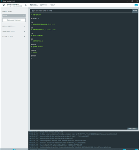

I'm trying to use GNSS on my Thingy:91 and flash it with the modem_shell application. IM using this device as my own apple air tag so i need gps readings, i followed tutorials online and nothing has worked, ive tested that it has network, the sim works, but the gnss wont work.

  4. Sent: AT+CGMR → White check mark Response: mfw_nrf9160_1.3.6
  5. Sent: help or gnss start → X Response: ERROR

  • Despite flashing modem_shell, the device behaves like it’s stuck in AT command mode
  • help and other shell commands give ERROR
  • GNSS functionality (e.g. gnss start) is not available
  • nrf cloud cant find device

    Flashed this firmware using nRF Connect Programmer: I downloaded the latest firmware 1.3.7 from nordics website.
    You say that you're running the latest 1.37 modem_shell, while your AT command states that the modem firmware is 1.3.6:
    Please match those.

  • Thank you so much for your fast response, this is the first tutorial i followed but it didn't work properly for me(https://www.youtube.com/watch?v=TbbDD9Z6HUg), and then after it failing and me trying and trying again i followed this tutorial as its super simple and get me exactly where i need to be (https://www.youtube.com/watch?v=U6wf2U34XO8). however despite following the instructions but with some of the latest firmware(which i now know i need o match properly) it was unsuccessful, i will add a screenshot of how it does following that tutorial because everything is OK until i try read gps.  . Is there any chance you could direct me to the exact files i need to flash my device with?
