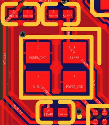

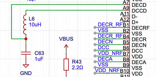

I designed a custom PCB with the nrf5340 CLAA chip and am testing out the board. I want to flash a simple project of lighting up the on-board LED (the LED is connected to P1.07 in my board design). In nrf connect SDK in VS Code, I was able to create a custom board for nrf5340 QKAA (I was told this is fine for CLAA too), add the GPIO pin P1.07 in the DeviceTree, build the project without errors and flash the code to my board via JLink successfully. However, the LED is not lighted up. When I tried to debug, the process always stops at the step “Starting target CPU…” and won’t let me proceed.
I also tried to control the LED directly using JLink.exe via command line (I am using a windows machine because I encountered more issues on mac). I could connect to the chip in JLink. However, I was not able to write the values directly to the registers to light up the LED either. I wrote the values but when I checked the memory at the address, it was still 0. I checked the soldering of my board physically and they are all connected. I measured RESET and Power and they are both around 3.3V. Is there anything that you think I should try to solve this issue? Is there anything specific I should do to flash the code for the first time? (E.g. the chip is initially locked/protected so we can’t write to its memory directly for the first time?) Any advice would be appreciated. Thanks!

  • Hi again Ke
    As Edvin suggested in the HW review ticket, please try following his suggestion to disable the DCDC regulator as per the instructions in this ticket. Note that you're using the one of the newer SDKs, so please start out with the new way of setting it. You can start following the guide from "Then you are using an NCS version where the new way of setting this applies."
    For your questions in the other thread, yes these changes will also apply to custom boards and custom board files. Also note that if the board doesn't get detected enabling the DCDC regulator for a design without the necessary components present might result in the board not working as expected, so you should make these changes and test on a new nRF5340 SoC/custom board design.

  • Hi Simon,
    Thanks for getting back to me. I was able to try what Edvin suggested in the private ticket to set the DCDC regulators off but unfortunately it did not solve my problem. The LED is still not working, I am not able to directly write to registers and I am not able to debug as well.
    Just want to mention that I am using a TPS62743 Buck Converter on another board which is connected to the board I uploaded in the private ticket to convert the voltage from the Lipo battery to 3.3V. And the output voltage is indeed measured to be 3.3V. I followed the recommended decoupling for nRF5340 CLAA chip, Config 2, when I designed the board. Hence, I think I do have inductors and capacitors connected to Pin A9 (DCCD) and B6 (DCC) which I believe are related to the usage of APP and NET DCDC regulators, as shown in the schematic I uploaded in the private ticket. Hence, I am only disabling the High-Voltage regulator by adding the lines below into a file called nrf5340_platform_nrf5340_cpuapp_ns.overlap in my application folder:
    &vregh {
        status = “disabled”;
    Please note that I also tried disabling all three DCDC regulators but the result turns out to be the same. When I build my project, I set the board target to be nrf5340_platform/nrf5340/cpuapp/ns which I created from the board of nRF5340 in nRF Connect and it is able to build successfully. I am attaching my entire application folder at the end so that you can see my board definition.
    As you can see, I am setting P1.07 high in the main.c:
