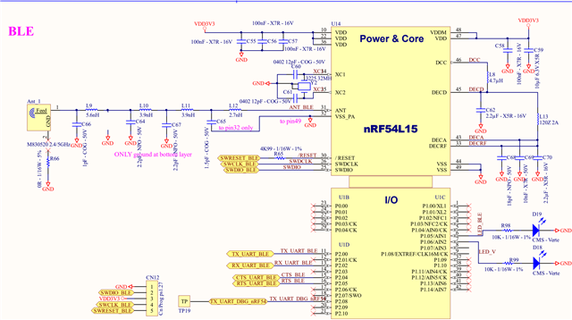

We are currently working on a new product based on NRF54L15.
Goal :
We are trying to set up the "Bluetooth LE UART service" example in order to transmit and receive data via BLE (nrf connect for mobile) and display the data in a serial monitor.
Configuration :
1) This is the schematic
2) This is the "nrf54l15dk_nrf54l15_cpuapp.overlay"

    I found a similar issue here nRF54L15: UART pinout not working unless connecting the RTT viewer.
    This appears to be a temporary workaround :
    #include <uart_async_adapter.h>
    int main(void) {
      NRF_TAD->ENABLE = 1;
    It would be interesting to understand why the application require this special mode (Enable debug domain and aquire selected GPIOs).
    Do you have any information on the subject ? Thanks

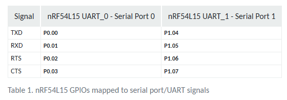

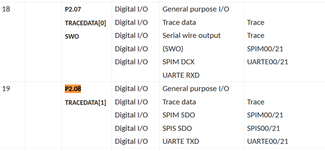

    Apart from the default pin sets for UART communication on NRF54L15
    You Can connect across power domains to dedicated pins on P2. You have to change the overlay file.
    Selected pins of P2 can be used for some serial interfaces in the peripheral domain — SPIM, SPIS, and UARTE. This is not the most power-efficient way of connecting these serial interfaces but adds flexibility when designing a circuit board. When setting up the peripheral's PSEL register for cross-domain connections, it must be connected only to the corresponding function listed in the pin assignments table. For example, the peripheral's PSEL.SCK register must use the P2 SCK pin from the pin assignment table. The pin assignments table shows which pins can be configured for cross power-domain connections.
    You have to change the device tree accordingly, in the hardware the RX and TX pin should be powered from the default pin; as its mentioned in the previous case ''Connected wires from P1.04/05 -> P2.07/08 on the DK for easier access to the uart console.''. You can also connect P2.07 or P2.08 with external UART or US converter.
    You also need to add this kconfig in the prj.conf file
    CONFIG_SOC_NRF_FORCE_CONSTLAT=y
