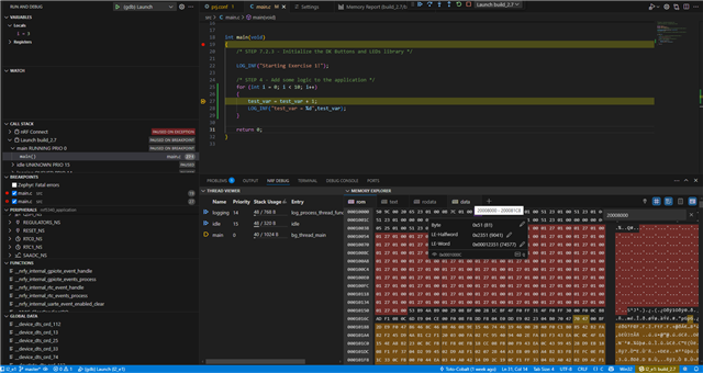

    2. Anyhow, I tried to run l2_e1_sol, but I have the same issue. When the debug is stopped at the first breakpoint which is at the main(), I tried to select any other tabs in Memory explorer, but only ROM is selected and cannot move to other tabs.
    3. When I continue the debugging by pressing F5 button, the error occurred.
    /__w/_temp/workspace/build/.build/HOST-x86_64-w64-mingw32/arm-zephyr-eabi/src/gdb/gdb/infrun.c:5825: internal-error: finish_step_over: Assertion `ecs->event_thread->control.trap_expected' failed.

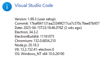

    I also checked my VS Code is not updated, but it's already the latest one.

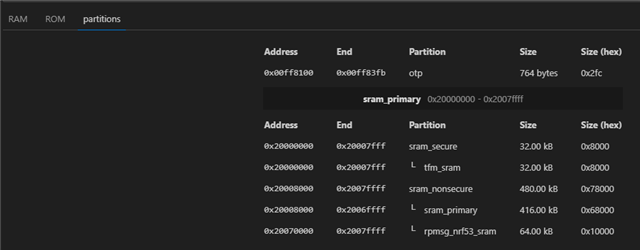

    I also checked the memory area, and it looks like data area is properly reserved.

  • Are you able to click the Go to Symbol icon in the upper right-hand corner in the memory explorer window, and Type in the global variable test_var? Will it show up as Step 6.5 in the lesson 2 exercise 1?
  • No.
    1) Nothing appeared on the top when I search test_var with "go to symbol"
    2) I also tried "go to address", but it has the same problem.

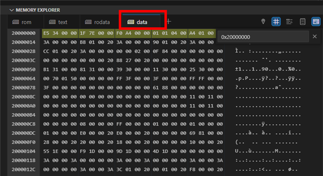

  • I am using the nRF9151DK with the nRF Connect for VS Code Extension Pack, version 2025.4.4, and I am experiencing a similar bug. However, I can only access the data tab:
    I am clicking on the ROM, text, and rodata tabs, but they do not change.
