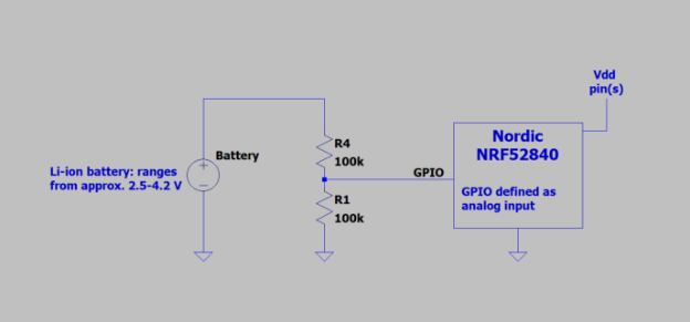

Here’s our situation: we are monitoring a battery voltage using a resistive voltage divider, as shown below in a simplified version of our schematic.  (I’ve left out things like the on/off switch, the regulator that powers the NRF52840, etc.)  The output of the voltage divider feeds a GPIO that is defined as an analog input. Because the battery is always connected to R4, the GPIO voltage is always present - regardless of whether or not the Nordic chip has power.

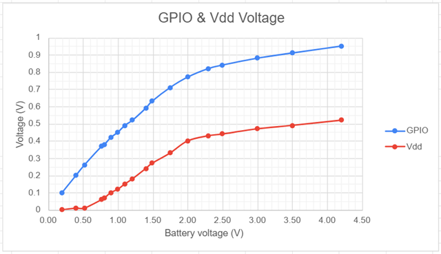

I took measurements to help understand the situation.  I used a benchtop power supply in place of the battery and varied it from 0 to 4.2 V.  I didn’t turn our device on so that the NRF52840 would be unpowered (i.e. Vdd = 0).  I measured the voltage at the GPIO pin and the Vdd pin.  I also used these voltages & the nominal resistor values to calculate currents.  The results are shown below.
   Chart 1
 Chart 1 - things to note:
  1. The GPIO voltage isn't linear.  Not too surprising.  You’d expect a linear response if the circuit was acting like an ideal voltage divider - but we know it isn't.
  2. The Vdd pin never gets high enough to power up the Nordic chip.  The minimum operating voltage for the NRF52840 is 1.7 V, and Vdd is only getting to ~0.5 V.

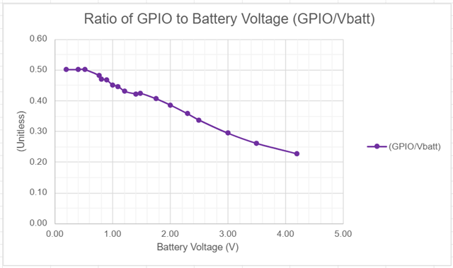

                                       Chart 2
Chart 2 - things to note:
  1. This ratio isn’t flat.  Again, not a surprise. If we had an ideal voltage divider with two equal resistors, we should see a flat line at 0.5 V because the output of the voltage divider would be half of the input.  Clearly we don’t see that.

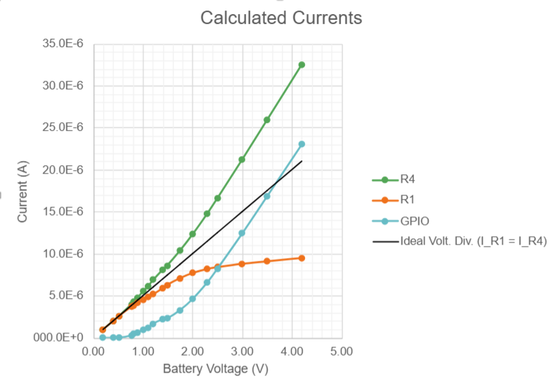

                                        Chart 3
 Chart 3 - things to note:
  1. For battery voltages up to 0.8 V, the circuit acts like an ideal voltage divider (GPIO current is zero; currents through R1& R4 are equal).  At a battery voltage of 0.8 V, however, current begins to flow into the Nordic GPIO pin.  (Note from the first chart that when the battery is at 0.8 V, the GPIO voltage is 0.4 V.  Perhaps 0.4 V is enough to turn on an internal diode?)
  2. The total current flowing into the GPIO pin is very small (uA) - likely because of the 100k resistor R4.  This probably prevents any permanent damage from occurring.
  3. Because the GPIO pin is drawing current, more leakage than necessary will occur when the Nordic chip is powered down.  This will drain the battery faster during extended periods of off time.

  • Terrible idea to use a voltage divider without a cutoff transistor or similar circuitry. You are not supposed to load a discharged Li-ion battery at all - that could set it on fire AFAIK.
    The voltage into the Nordic chip is the least of your problems.
    Expect fun stuff like randomly erased flash pages in the field due to brownouts. The diode from the pin to VDD rail is not intended for this kind of abuse, but it probably won't blow up.
  • Best test is to repeatedly remove and replace the battery with various delays and see if there are are any hangup issues.
    Best fix might be to switch to a flying-capacitor sample where no potential divider is required; suggest 10nF fixed and 10nF fly from same supplier, nc connects C1 to C2 and port pin discharges both then switch pin to saadc mode, switch on then switch off: vin to saadc is then Vbatt/2. Only static drain is minuscule analogue switch supply, use break-before-make type.
