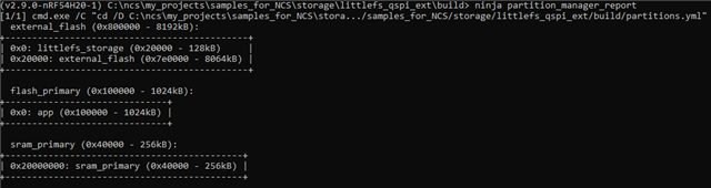

    There were one more thing missing:
    https://docs.nordicsemi.com/bundle/ncs-latest/page/nrf/scripts/partition_manager/partition_manager.html says that to use CONFIG_PM_PARTITION_REGION_LITTLEFS_EXTERNAL you  must add a chosen entry for nordic,pm-ext-flash in your devicetree.
    Here's a sample that showcases you this can be done as well as how I've configured the pm_static.yml. Alternatively to the pm_static.yml in the zip, you can also do the following if you wish to have the application and external flash statically configured:

    You can try this sample with your own pm_static.yml as well to compare.
    Resulting partition map:
    3583.littlefs_qspi_ext.zip
    Let me know if this works for you or if you're able to apply the changes I've made to the LittleFS sample to your own application

  • In my case I had not created partitions in the overlay file that is why it was not working. I have followed the overlay example on 3583.littlfs_qspi_ext.zip and I managed to read the partitions in main.c file.
    I had assumed that I only need partitions in pm_static.yml file but my assumptions were wrong.
