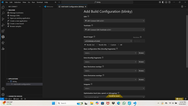

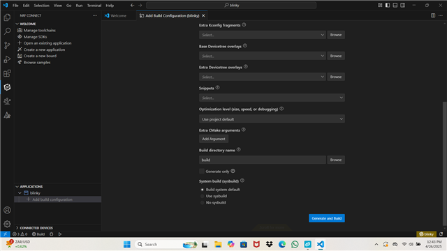

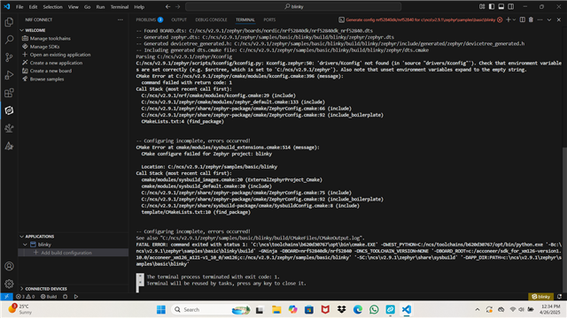

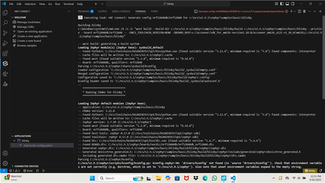

Good day,

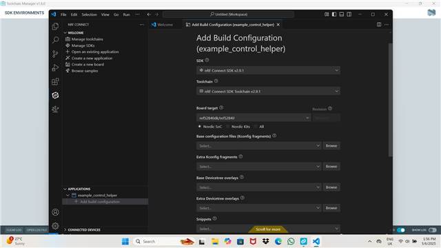

I tried to build the standard Nordic application: Blinky for the nrf52840dk/nrf52840 board from the following directory on my PC: c:\ncs\v2.9.1\zephyr\samples\basic\blinky.
I was using:
1. VS Code
2. nRF Connect SDK v2.9.1
3 nRF Connect SDK Toolchain v2.9.1
4. Board Target:  nrf52840dk/nrf52840
as shown on the attached Screenshot_3 and Screenshot_4.
However, some error messages came up, as shown in the attached Screenshot_5 and Screenshot_2.
I also attach the whole build log split between the attached Screenshot_1 and Screenshot_2 - as I could not find an easy way to save or print the whole log file.
What shall I do to successfully build that application?
JM

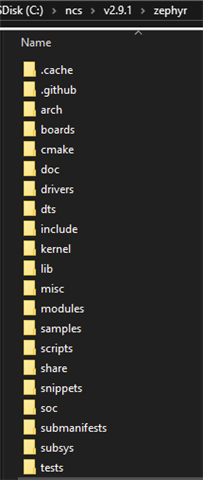

  • Hi JM,
    It looks like there is something wrong with your toolchain or SDK.
    When you installed nRF Connect SDK, did you follow all the instructions here
    Have you modified or moved any directories after installation? The error refers to "drivers/Kconfig" missing. Can you verify that "ncs/v2.9.1/zephyr/drivers/Kconfig" exists on your PC?
    nRF Connect for VS Code has a feature to refresh the SDK and toolchain. If you are not familiar with that feature, they are found by hovering over Manage toolchains/SDKs as a circle arrow.
    Maria

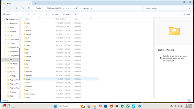

  • Hi Maria,
    I tried to verify that "ncs/v2.9.1/zephyr/drivers/Kconfig" exists on my PC - but it does not exist.
    I then tried to refresh the SDK and toolchain by clicking a circular arrow in the Manage toolchains/SDKs.
    I then tried to verify that "ncs/v2.9.1/zephyr/drivers/Kconfig" exists on my PC - but it still did not show in the "ncs/v2.9.1/zephyr" directory, as shown on the attached Screenshot.
    I recently installed on my PC the nRF Connect SDK v2.7.0 - then I removed that v2.7.0 version and I installed the nRF Connect SDK v2.9.1.
    Then, after experiencing some issues, I re-installed the nRF Connect SDK v2.9.1 (by removing it and then by installing it again).

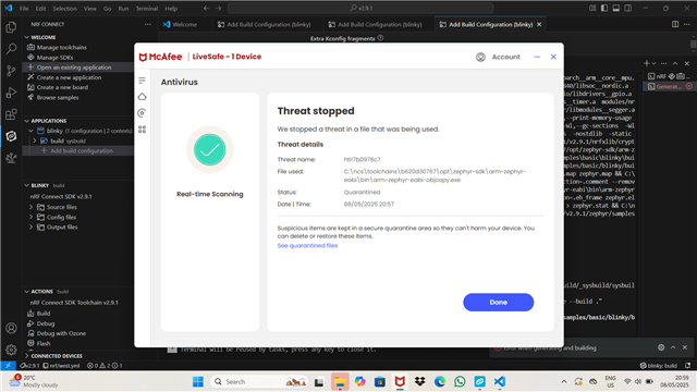

  • Hi JM,
    Antivirus software can report false positives for some files in our toolchain. Restoring it should not cause damage to your machine.
    Maria

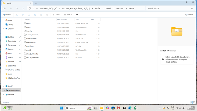

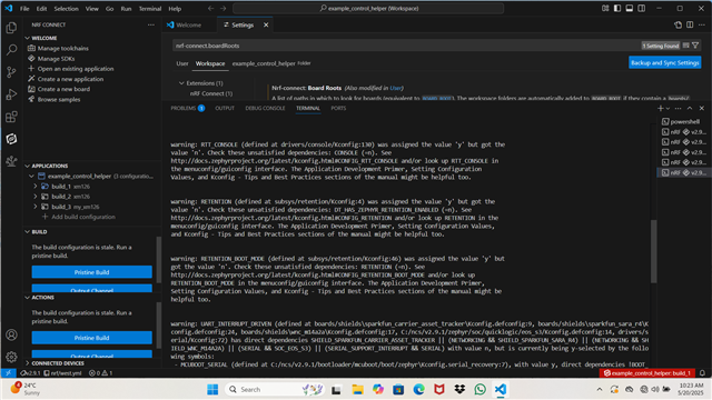

    After I clicked "Create Board", I saw the message: "Board xm126 has been created at: c:\Acconeer_SDK_v1_10\acconeer_xm126_a121-v1_10_0_(1)\xm126 and I was able to verify that the board xm126 has been created on my PC in the directory: c:\Acconeer_SDK_v1_10\acconeer_xm126_a121-v1_10_0_(1)\xm126\boards\acconeer\xm126
    as shown on the attached Screnshot_1.

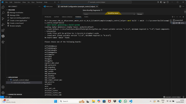

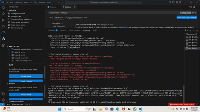

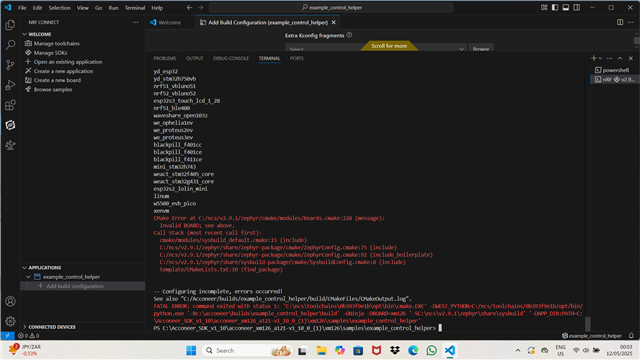

    I then tried to build configuration for the Acconeer example: "example_control_helper" for my newly created board: xm126, using the following west build command:
    west build -b xm126 -d c:\Acconeer\builds\example_control_helper\build
    but the following error came up:
    "No board named 'xm126' found. Please choose one of the following boards: ...
    - as shown on the attached Screenshot_2.
    and the message:
    CMake Error at: c:/ncs/v2.9.1/Zephyr/cmake/modules/boards.cmake:228 (message): Invalid board; see above.
    -as shown on the attached Screenshot_3.
    So, despite the new board: xm126 having been created in the folder: c:\Acconeer_SDK_v1_10\acconeer_xm126_a121-v1_10_0_(1)\xm126\boards\xm126\acconeer\xm126 - the west build command generated Error Message: "No board named 'xm126' found".
    How can I overcome this problem to be able to successfully build configuration for the Acconeer example: "example_control_helper" for my newly created board: xm126 ?

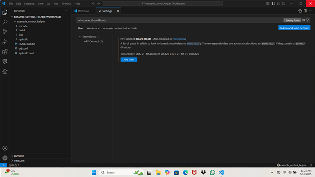

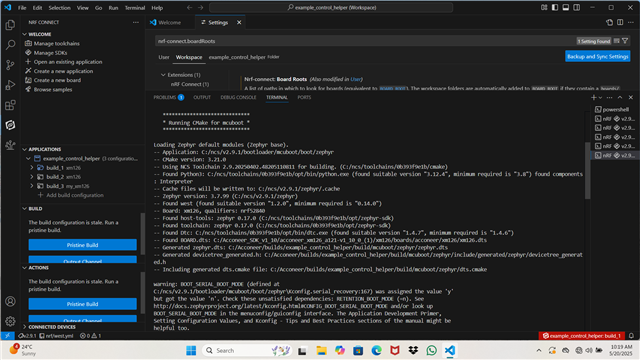

    The nrf-connect.boardRoots setting may not have been updated after creating the board. You can check this by opening the VS Code Workspace settings and searching for the extension setting. If there are no paths listed, or if the path to your custom board is not listed for the setting, you can add it with "Add Item".
    Note that the newly created board files are very generic, and that if you have board files already prepared in the Acconeer SDK you can use those instead of creating a new custom board. You can add the path to the board file location in the Acconeer SDK to the nrf-connect.boardRoots setting in that case.
    Maria

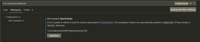

  • Hi Maria,
    Thanks for your reply.
    Can you advise on the following:
    1. How can I open the VS Code Workspace settings?
    2. How exactly can I add the path to the board file location in the Acconeer SDK to the nrf-connect.boardRoots setting - instead of creating a new custom board?
    I attach a screenshot of the path to the board file location in the Acconeer SDK, which is: C:\Acconeer_SDK_v1_10\acconeer_xm126_a121-v1_10_0_(1)\xm126\boards\acconeer\xm126
    JM
  • Hi JM,
    You can open the command search in VS Code with CTRL+SHIFT+P and search for (workspace) settings.
    In the "search settings" field, search for nrf-connect.boardRoots
    As you can see from my screenshot above, I have added a path to the setting. I used "Add Item" and pasted the full path to the folder with the build file.
    Maria

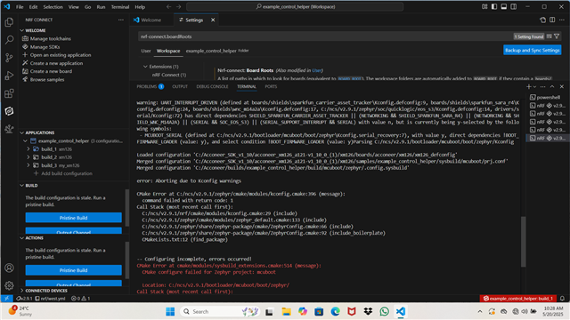

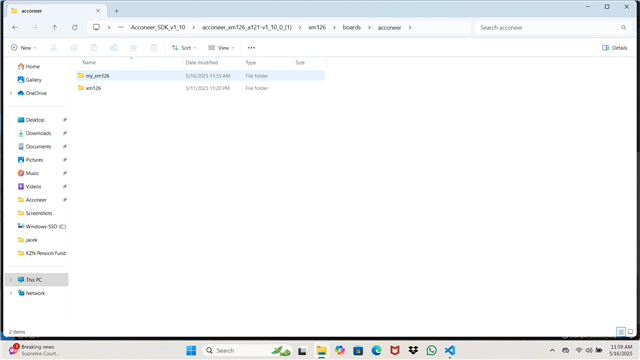

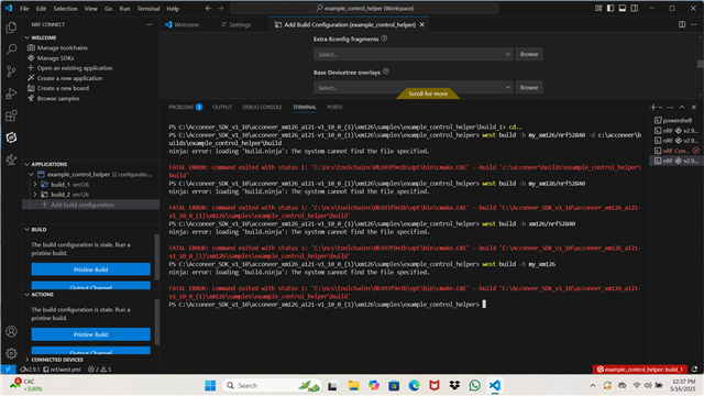

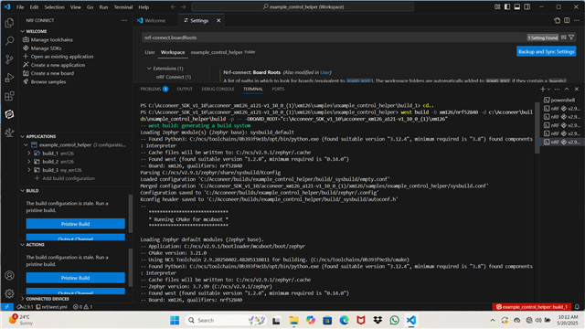

  • Hi Maria,
    As advised, I added the path to the file location in the Acconeer SDK to the nrf-connect.boardRoots  by clicking "Add Item" and entering the full path to the folder with build file, as shown on the attached Screenshot_1.
    I then created another new board named "my_xm126" with the Board Root as: c:\Acconeer_SDK_v1_10\acconeer_xm126_a121-v1_10_0_(1)\xm126
    When I clicked "Create board" - I saw the message: "Board my_xm126 has been created at   c:\Acconeer_SDK_v1_10\acconeer_xm126_a121-v1_10_0_(1)\xm126  and I verified that my new board: my_xm126 has indeed been created in the above folder, as shown on the attached Screenshot_2.
    Now, when i click on "+Add Build configuration" I can select under the "Custom" board target, the following two custom boards that I have created: "my_xm126/nrf52840"  and "xm126/nrf52840".
    So I selected "my_xm126/nrf52840" as the board target and I clicked "build configuration"- but many errors came up.
    So, I tried to use the following west build command for my board target "my_xm126/52840":
    west build -b my_xm126/52840 - but the following fatal error came up: "ninja:error: loading'build.ninja':The system can not find the file specified" - as shown on the attached Screenshot_3.
    What else can I do to successfully build configuration for the Acconeer example: example_control_helper  for the Acconeer xm126 module , for which I have created the custom board "my_xm126 with the custom board target: my_xm126/nrf52840 ?
    Best regards
    JM

      229 | #define DEVICE_DT_NAME_GET(node_id) DEVICE_NAME_GET(Z_DEVICE_DT_DEV_ID(node_id))
    C:/ncs/v2.9.1/zephyr/include/zephyr/device.h:246:34: note: in expansion of macro 'DEVICE_DT_NAME_GET'
      246 | #define DEVICE_DT_GET(node_id) (&DEVICE_DT_NAME_GET(node_id))
    C:/ncs/v2.9.1/zephyr/include/zephyr/drivers/gpio.h:333:25: note: in expansion of macro 'DEVICE_DT_GET'
      333 |                 .port = DEVICE_DT_GET(DT_GPIO_CTLR_BY_IDX(node_id, prop, idx)),\
    C:/ncs/v2.9.1/zephyr/include/zephyr/drivers/gpio.h:369:9: note: in expansion of macro 'GPIO_DT_SPEC_GET_BY_IDX'
      369 |         GPIO_DT_SPEC_GET_BY_IDX(node_id, prop, 0)
    C:/ncs/v2.9.1/zephyr/samples/basic/blinky/src/main.c:21:40: note: in expansion of macro 'GPIO_DT_SPEC_GET'
       21 | static const struct gpio_dt_spec led = GPIO_DT_SPEC_GET(LED0_NODE, gpios);
    In file included from C:/ncs/v2.9.1/zephyr/include/zephyr/arch/arm/arch.h:20,
                     from C:/ncs/v2.9.1/zephyr/include/zephyr/arch/cpu.h:19,
                     from C:/ncs/v2.9.1/zephyr/include/zephyr/kernel_includes.h:36:
    C:/ncs/v2.9.1/zephyr/include/zephyr/devicetree.h:240:32: error: 'DT_N_ALIAS_led0_P_gpios_IDX_0_VAL_pin' undeclared here (not in a function)
      240 | #define DT_ALIAS(alias) DT_CAT(DT_N_ALIAS_, alias)
    C:/ncs/v2.9.1/zephyr/include/zephyr/devicetree.h:4888:9: note: in definition of macro 'DT_CAT7'
     4888 |         a1 ## a2 ## a3 ## a4 ## a5 ## a6 ## a7
    C:/ncs/v2.9.1/zephyr/include/zephyr/devicetree/gpio.h:110:9: note: in expansion of macro 'DT_PHA_BY_IDX'
      110 |         DT_PHA_BY_IDX(node_id, gpio_pha, idx, pin)
    C:/ncs/v2.9.1/zephyr/include/zephyr/drivers/gpio.h:334:24: note: in expansion of macro 'DT_GPIO_PIN_BY_IDX'
      334 |                 .pin = DT_GPIO_PIN_BY_IDX(node_id, prop, idx),                 \
    C:/ncs/v2.9.1/zephyr/include/zephyr/devicetree.h:240:25: note: in expansion of macro 'DT_CAT'
    C:/ncs/v2.9.1/zephyr/samples/basic/blinky/src/main.c:15:19: note: in expansion of macro 'DT_ALIAS'
       15 | #define LED0_NODE DT_ALIAS(led0)
    C:/ncs/v2.9.1/zephyr/samples/basic/blinky/src/main.c:21:57: note: in expansion of macro 'LED0_NODE'

    FAILED: _sysbuild/sysbuild/images/blinky-prefix/src/blinky-stamp/blinky-build C:/ncs/devzone/344510/my_builds/build_2/_sysbuild/sysbuild/images/blinky-prefix/src/blinky-stamp/blinky-build
    cmd.exe /C "cd /D C:\ncs\devzone\344510\my_builds\build_2\blinky && C:\ncs\toolchains\b620d30767\opt\bin\cmake.exe --build ."
    FATAL ERROR: command exited with status 1: 'C:\ncs\toolchains\b620d30767\opt\bin\cmake.EXE' --build C:/ncs/devzone/344510/my_builds/build_2
    If there is a failed build in the directory you are using, this error is common. By building pristinely, the build system creates 'build.ninja' again.
    Also, the nrf-connect.boardRoots setting are only applied when creating build configurations in the extension, to build from command line, add -- -DBOARD_ROOT="c:\Acconeer_SDK_v1_10\acconeer_xm126_a121-v1_10_0_(1)\xm126" to the build command (as well as pristine).
    So to summarize, your build should succeed if you have modified the board files to reflect the board hardware and use the following build command from the sample directory:
    west build -b xm126/nrf52840 -d c:\Acconeer\builds\example_control_helper\build -p -- -DBOARD_ROOT="c:\Acconeer_SDK_v1_10\acconeer_xm126_a121-v1_10_0_(1)\xm126"
    Maria
  • Hi Maria,
    As advised, I tried to use:
    west build -b xm126/nrf52840 -d c:\Acconeer\builds\example_control_helper\build -p -- -DBOARD_ROOT="c:\Acconeer_SDK_v1_10\acconeer_xm126_a212-v1_10_0_(1)\xm126"
    During the build process some warnings showed up, like:
    warning: BOOT_SERIAL_BOOT_MODE - as shown on the attached Screenshot_2.
    warning: RTT Console, warning: RETENTION, warning: RETENTION_BOOT_MODE and warning: UART_INTERRUPT_DRIVEN - as shown on the attached Screenshot_3.
    And then an error message came up:
    "error: Aborting due to Kconfig warnings. CMake Error at: c:/ncs/v2.9.1/zephyr/cmake/modules/kconfig.cmake:396 (message)" - as shown on the attached screenshot_4.
    And the final error message showed up:
    "--Configuring incomplete, errors occurred!" - as shown on the attached Screenshot_5.
    What else shall I try?
    JM
    You should go through the build log and find the Kconfig dependencies which are not met and enable them for the example and for MCUBoot. We have documentation pages on how to configure your application with Kconfig and how to customize the bootloader which you can use for reference.
    Maria
