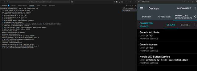

I'm testing BLE secure communication with the nRF52840DK device and I have encountered a problem with bonds. I use modified example from BLE fundamental course, in which I added ability to determine if we connected to new or bonded client. The following steps will better describe my issue:
  1. Perform connection, pairing, and bonding with the nRF52840DK(Nordic_LBS).
  2. Subscribe to Button characteristic notification(write to its CCCD 0x0001 value).
  3. Disconnect from nRF52840DK(Nordic_LBS).
  4. Remove bonds on the client's side. (Bonds on nRF52840DK(Nordic_LBS) still present):
  5. Perform connection with the same nRF Connect client. As you can see, nRF52840DK(Nordic_LBS) still assume that it bonded with client.
  6. Check Button characteristic CCCD value.
Expected result: 0x0000
Actual result: 0x0001
Same situation occurs even if in step 5 I perform connection, pairing, bonding again with the device. nRF connect logs and modified example attached.

  • Hi Biliy,
    I believe it's not a bug but a feature.
    When you connect to a previously bonded device and the device now has removed bond with you, you are not expected to remove the previous bond and remove the gatt cache (CCCD cache)
    The reason for that is that an attacker can easily spoof the peer device address and pretend that the bond has been removed (and maybe request a new bond).
    You can either allow overwriting using this config CONFIG_BT_SMP_ALLOW_UNAUTH_OVERWRITE (only for just work) or request end user proactively remove bond on the device itself.
    So from my point of view GATT cache should not be automatically removed. It should only be remove when delete bond button is pressed/selected on the device itself.

  • Hi Billy,
    As far as I know Zephyr won't allow a re-pairing with the same central (unless you configured so, and only applied for Justwork).
    As mentioned earlier, the way it should work in my opinion is that when the central deletes bond, the peripheral need to delete the bond to the same central as well. How the peripheral delete bond depend on the design choice, either having a physical button or having an encrypted command (proprietary) to erase bond.

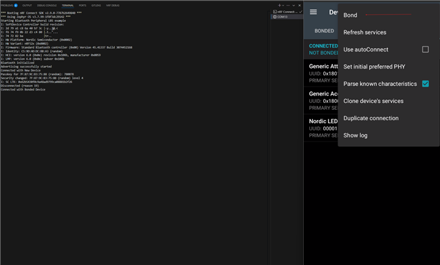

    Could you describe how you did this " I reconnect  (as in step 5) and perform a new pairing and bonding additionally, the peripheral still attempts to send indications on value update, " ?

  • Hi Hung,
    To perform a new pairing, I pressed the "Bond" button again in the nRF Connect app after reconnecting in step 5:
    And after that, the pairing completes successfully:
