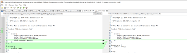

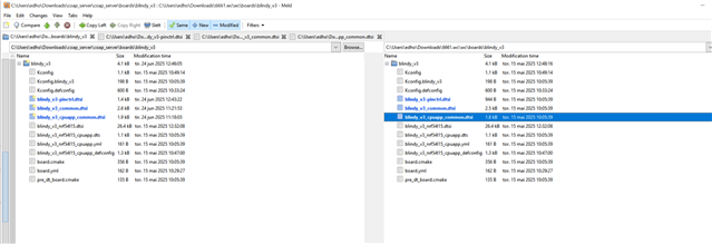

  • Please correct me if I'm wrong. Until the last sentence, is this what you did:
    Take the board files that I sent which are named (something like) blindyv3_nrf54l15_cpuapp which basically is a copy of the 54l15 DK and flash it to a nRF54L15DK and this did not work, but when building it with for nrf54l15dk/nrf54l15/cpuapp it compiled and ran on the 54L15DK everything worked?
    If so, then that makes sense. The DK's won't run unless you've built the firmware for the DK, even though the custom board files are identical albeit with a different file name.
    Yes that is exactly what I did. But why would it not run if the board definition is identical? If that is the case how would I start developing a board definition for my own board? My plan was to take an example that works. Create my own board file for that and then run the example on the DK with my own board file. Then once that is working start changing the board file to match my own schematic and if something breaks I can still go back to the working example on the DK.
    Tiit

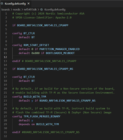

    It is only identical if the file names also are identical
    There are various items that may be hardcoded to be configured for usecases where a DK is built for. For instance, the ZMS configuration that we mentioned. It might be that they're picked up due to the SoC family that you define in one of the custom files, but it will still differ from the DK's board files since it uses a different name.  Some of those Konfigs can be seen here:
    In other words, there are things that you and I can't just assume will work unless you go through all of these files.
    Tiit said:

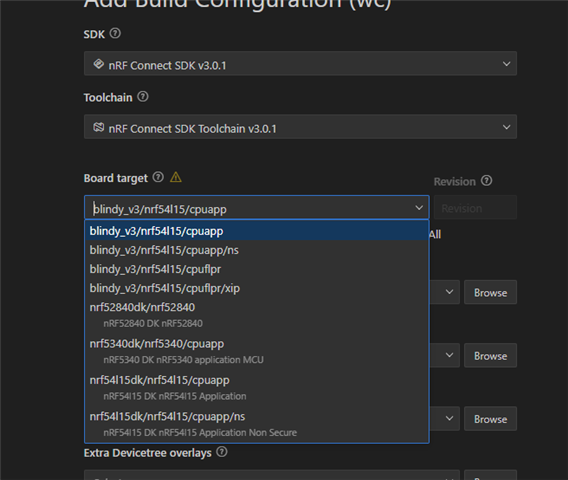

    I used the custom board folder that now compiles as a target for building three separate images. I first manually changed my copy with your suggestions until I could compile that. After flashing that to the nRF54L15-DK it doesn't do anything.
    But if I were to guess, I would assume that the ROM offset config in the image above may be why your application does not start in the quote above
    FYI, I'm not certain if I've linked this before or if you've seen it, but just to be sure https://academy.nordicsemi.com/courses/nrf-connect-sdk-intermediate/lessons/lesson-3-adding-custom-board-support/
    Andreas

  • Tiit said:
    You mentioned the ROM offset. How would I investigate this further?
    You would have to investigate the board files within the SDK, for instance the defconfig file within the board foalder or search in the SDK for for instance "if BOARD_NRF54L15" and shee where unique pickups for the board are made.
    The Matter samples may also have their own custom definitions for the nRF54L15, such as the settings backend (NVS vs ZMS) due to the memory type

  • No worries, and sorry for not being more helpful/clear.
    The ZMS thing is just an example I'm bringing up as things that you need to look for w.r.t what you might be missing. You can set it up through configurations instead. The Matter samples simply automatically include ZMS for that build target since ZMS is better than NVS is for RRAM.
    If you find anything that depends on the 54l15dk board target that you try to port to your custom board based on the 54l15dk then you need to add that so that the sample compiles to exclude what the root cause may be.
