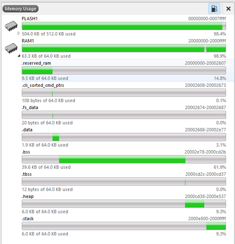

This is the current memory allocation for this project, and it is fed up quite to its limit:
Any advice is greatly appreciated!

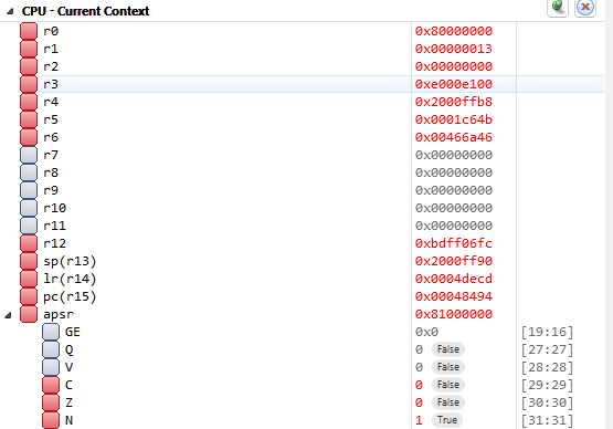

  • Hi Vidar,
    Thanks for the response. I am using Softdevice s132_nrf52_7.2.0_softdevice with nRF5 Software Development Kit v17.1.0.
    Below is the content of call stack and CPU register:

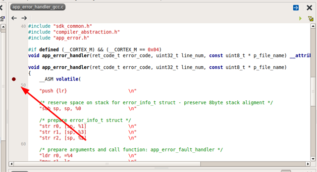

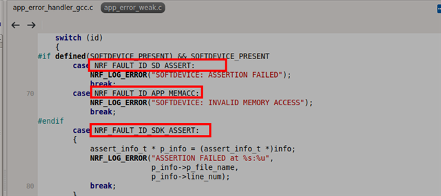

  • Hi Kevin,
    The "id" argument passed to the error handler is supposed to correspond to one of the switch case statements, but it doesn't. Therefore, I'm not sure we can trust the PC to be correct either.
    Please try to place a breakpoint at the beginning of the app_error_handler() and check if the call stack will reveal more information.
    Vidar

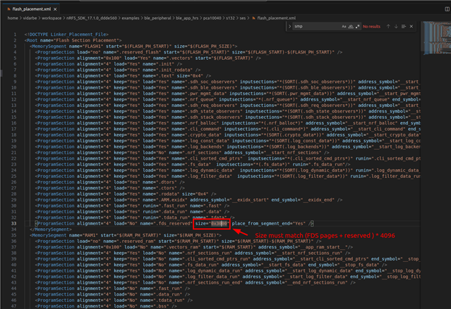

  • Hello Kevin,
    I see. The picture you posted of the memory usage earlier shows that the application code has expanded well into the FDS area. fds_init() will return FDS_ERR_NO_PAGES if it is unable to tag at least one swap and one data page (page tag). This will happen if for instance the page tags as been overwritten by something else (by application code in this case).  Since the FDS area is not statically allocated you will not get a linker error when the app grows into the fds area.
    To ensure errors such as this is caught at link time, you can try to add the section below to your flash_placement file:
    <ProgramSection alignment="4" load="No" name=".fds_reserved" size="0x3000" place_from_segment_end="Yes" />
