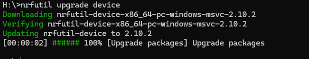

  • After reading this I tried nrfutil upgrade device again, and got the same response that it was already at the newest version (2.3.6). Then I discovered the self-upgrade command, and ran that, It did update. After that, nrfutil upgrade device did upgrade to 2.10.2. Again, this is on Windows 11.

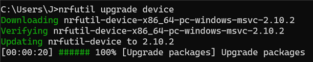

  • i was facing issue is like
    logs :
    Flashing build_nrf54840dk to 1050266177
    C:\WINDOWS\system32\cmd.exe /d /s /c "west flash -d c:\Users\J\Downloads\ncs-inter-main\l9\l9_e5\build_nrf54840dk --dev-id 1050266177"
    -- west flash: rebuilding
    [0/10] Performing build step for 'l9_e5'
    ninja: no work to do.
    [1/10] Performing build step for 'mcuboot'
    [4/10] cmd.exe /C "cd /D C:\Users\J\Downloads\ncs-inter-main\l9\l9_e5\build_nrf54840dk\_sysbuild && C:\ncs\toolchains\0b393f9e1b\opt\bin\cmake.exe -E true"
    [6/9] No install step for 'mcuboot'
    [7/9] Completed 'mcuboot'
    [8/9] cmd.exe /C "cd /D C:\Users\J\Downloads\ncs-inter-main\l9\l9_e5\build_nrf54840dk\_sysbuild && C:\ncs\toolchains\0b393f9e1b\opt\bin\cmake.exe -E true"
    -- west flash: using runner nrfutil
    -- runners.nrfutil: reset after flashing requested
    -- runners.nrfutil: Flashing file: C:\Users\J\Downloads\ncs-inter-main\l9\l9_e5\build_nrf54840dk\merged.hex
    error: unexpected argument '--x-ext-mem-config-file' found
    tip: a similar argument exists: '--x-qspi-config-file'
    Usage: nrfutil device <--json|--json-pretty|--skip-overhead> <--json|--json-pretty> <--x-qspi-config-file <PATH>>
    For more information, try '--help'.
    -- runners.nrfutil: Board with serial number 1050266177 flashed successfully.
    * Terminal will be reused by tasks, press any key to close it.
    my issue resolved after this execution.
    if you facing same then will work for you...
    share your logs..
