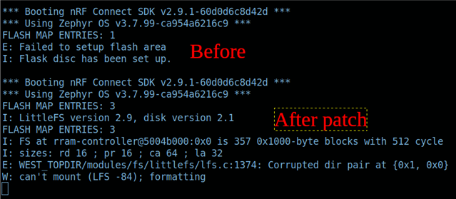

mismatch partition number from pm.config and runtime flash_map_entries on nrf54L15dk/external NOR Flash
PM_APP_OFFSET=0x0
PM_APP_ADDRESS=0x0
PM_APP_END_ADDRESS=0x165000

The attached code is based on a sample code from NCS v2.9.1 and creates a LittleFS flash disk on external SPI NOR onboard nrf54L15DK.
There is a mismatch in the code, when flash_map_entries should be 3 but is set as 1, mismatching from PM_NUM = 3.
Please, help to understand why this mismatch.

    Sorry for the delay. I do see there is a bug somewhere that prevents SPI NOR to be used with the flash disk driver when testing your sample project here, but I have not been able to figure out where yet. I will discuss this with the developers.

    On the nRF54L15 DK, the application would quickly hard fault with this log:
    *** Booting nRF Connect SDK v2.9.1-60d0d6c8d42d ***
    *** Using Zephyr OS v3.7.99-ca954a6216c9 ***
    Erasing flash area ...  [00:00:00.430,732] <err> os: ***** BUS FAULT *****
     [00:00:00.430,737] <err> os:   Precise data bus error
     [00:00:00.430,742] <err> os:   BFAR Address: 0x40480000
     [00:00:00.430,753] <err> os: r0/a1:  0x20003780  r1/a2:  0x00008001  r2/a3:  0x50120000
     [00:00:00.430,761] <err> os: r3/a4:  0x00000000 r12/ip:  0x20003780 r14/lr:  0x0000da13
     [00:00:00.430,765] <err> os:  xpsr:  0x29000000
     [00:00:00.430,769] <err> os: Faulting instruction address (r15/pc): 0x00008002
     [00:00:00.430,791] <err> os: >>> ZEPHYR FATAL ERROR 25: Unknown error on CPU 0
     [00:00:00.430,809] <err> os: Current thread: 0x20000dc0 (main)
     [00:00:00.503,479] <err> os: Halting system
    On the nRF52840 DK, the device would fail, but no log would be printed out.
    I was able to narrow down the failure to the fs_mount() call, but I haven't figured out why yet.
    I also have a question about the project. Is it designed to work with an empty external flash? I suspect the existing memory on my nRF52840 DK external flash to be at fault, so I erased it before testing. However, the issue persists.

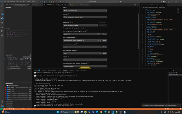

    I'm not capable of capture the hard fault in nrf54l15dk and it works for my nrf52840dk, even if there is a problem with my jedec data for flash memory but at least the partitions are recognized properly.
    Please, see these small videos capturing what happen in my side, this my clarify something for you.
    Let me know any other question you may have.
    Thank you very much for your effort.

  • Hi Carlos,
    First of all, my sincere apology for the long wait without follow up. I have been trying to figure out what could be wrong in your setup. However, such a debugging job is not easy to schedule during our understaffing situation, so I haven't made enough progress to respond to you, even though I feel really bad about keeping you waiting.
    Regarding the two videos you sent, the nRF54L15 shows that the execution paused in an exception handler. The nRF52840 one shows that while the execution was about to reach a point where flash initialization fails and an error is returned.
    A while back, I helped another customer setup the LittleFS sample to work with the nRF54L15 DK. The latest source code and a simple fix necessary to make it running are both provided in the case here:  Unable to Mount LittleFS File System On External Flash On NRF54L15-DK .
    I would like to recommend using this as a starting point instead, as further fixing the current project might take too much time while not yielding more benefit than this alternative.
    P.s: Here is the fixed reference project, for convenience.
    c346472_littlefs_250805_01.zip
