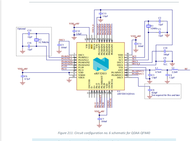

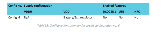

We are currently using the nRF52833-QDAA-R SoC for our R&D activities and have assembled the board based on Configuration 6. However, we encountered an issue during UART debugging:
  • When attempting to debug via FTDI using UART, no logs are observed.

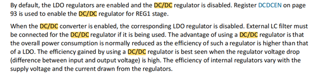

  • Interestingly, when we solder the 10 µH and 15 µH inductors along with the DCC pin, the UART logs begin to function properly.
Please note the following:
  • We are operating in normal voltage mode.
  • The DC/DC converter has not been enabled via register settings.

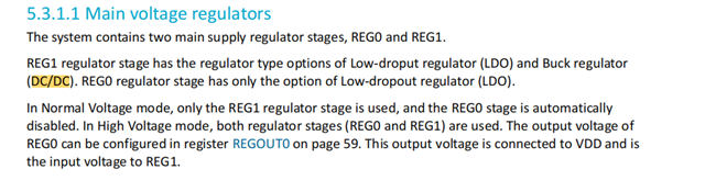

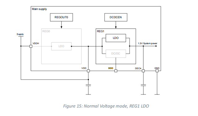

  • As per the datasheet, in this default state, the LDO regulator should be active, and the DC/DC converter disabled.
We kindly request your guidance on how the DCC pin and associated inductors might be affecting UART debugging, and whether we might be overlooking any critical design/configuration aspects.
