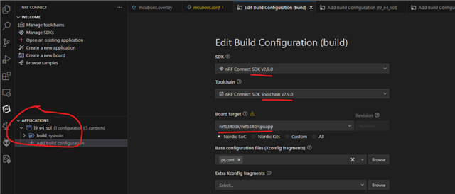

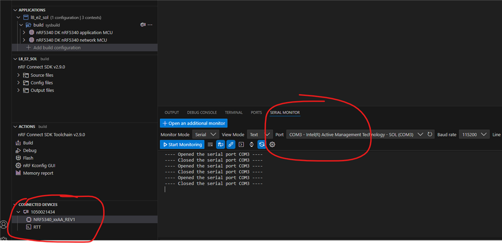

Hi Community,
I'm learning the sysbuild stuffs, try to upgrade my code to sdk v2.9.0.
Exercise 2 - Adding custom image - Nordic Developer Academy
I'm using nRF5340DK to run this exercise code, but I can't find the so called "UART30 " for output.
Could you please give me more instructions? thanks!
Regards
Danny
    Only the nRF54L15 uses the FLPR core. The nRF5340 uses the Network core, which is on UART0.

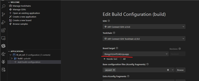

  • Hi
    I want to upgrade my code to sdk v2.9.0.
    Exercise 4 – DFU over USB
    Exercise 5 – FOTA over Bluetooth Low Energy
    these two features I need for my use case, I know they are currently only supported for nRF5340DK. I tried to compile DFU over USB for thingy53, seems not working.
    could you please share me how to make them also working for thingy53? because my board is similar as thingy53.
    Regards
    Danny

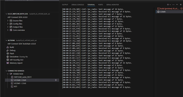

  • Regardless of the USB issue.
    the HCI issue happens again, it seems not a stable solution, it happens randomly.
    Actually during the debugging, I also found it's working only sometimes, even the same code doesn't work after another flash.
  • Hi
    I finally fixed it and it's stable.
    1. first of all, the board files of thingy53 has no issue.
    2. the configuration in ipc_radio.conf causes the issue, because here the UART is enabled, but in the  *_cpunet.dts of boards file uart0 is disabled. this causes conflict and HCI issue. So I just commented these out:
    #CONFIG_SERIAL=y
    #CONFIG_UART_CONSOLE=y
    #CONFIG_LOG=y
    no HCI issue happens again.
    please verify it and update the code for thingy53.

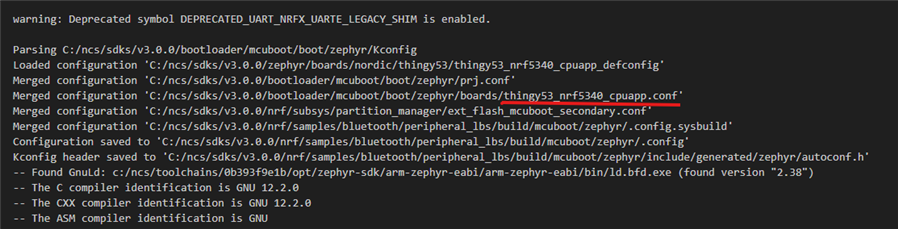

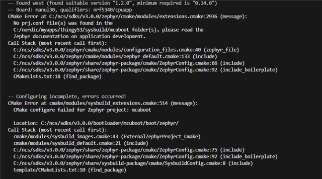

    3. last but lease, in the sdk v3.0.0/bootloader/mcuboot/boot/zephyr/boards these is a file named "thingy53_nrf5340_cpuapp.conf", which is also called during the building:
    if the code is compiled for a custom board, a similar file shall be added also, otherwise there will be lots of usb related "k_work* " errors.
    my question here is: how can I put this file under my project and make the building call it from my project? since it's a custom board related file, I dont want to put it into sdk source code.
    Regards
    Danny
    Good job!
    You can use sysbuild to add it.
    For example as project/sysbuild/mcuboot/boards/board_name.conf or as project/sysbuild/ipc_radio/boards/board_name.conf.
    See Lesson 8 – Sysbuild to learn more about Sysbuild.
