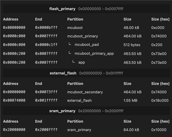

Due to the application’s size, we now want to use external SPI flash (W25Q16JV) to store the firmware during the update process. We believe our partitioning is configured correctly (see attached memory report screenshot), and we’ve integrated the external flash into the devicetree (via overlay) and enabled it in the build.

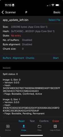

    As far as I know, the only time the upload can be skipped without any errors is if an image with the same hash already exists on the target device.  Please try our Device Manager which supports more mcumgr commands (available on both iOS and Android) and switch to the 'Advanced' view for image management. Then click the 'Read' button to get the slot information to see if this could be the case.

    Thank you for your reply. I downloaded the Device Manager app. You can see the 'Read' results in the screenshot.
    When I try the DFU, the state jumps to 'No entry'. Based on this information, do you have an idea of what might be the issue here?

    Thanks for the additional info. The slot readout shows that there is another FW image in the secondary slot marked as "pending" (different from the FW image you are trying to upload). I wonder if the issue is that the bootloader is not activating this update therefore causes the slot to remain in this state (slot can't be overwritten by another image when in the pending state). If you reboot the device (either by power cycling or resetting it) and then read out the slot again, does it still show as pending?
    Please also note that it is not possible to change the memory layout through DFU as mentioned here: "Static partition requirement for DFU". Doing so may lead to the same symptoms as you are observing.

    mcuboot_secondary matches the size of mcuboot_primary, which is also visible in the screenshot of the memory report I shared earlier.

    As long as the bootloader and all application versions are built with the same memory layout, I don't see how you could end up in this state. However, the pm_static.yml file you posted only defines the partition layout in external flash so it is still possible for the dynamic partitions in internal flash to become changed. To ensure the start address of the primary slot remains consistent as well, please use the generated partitions.yml file from the build directory as your pm_static.yml file, and make sure it is used in all builds.
