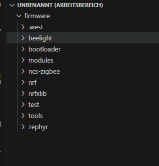

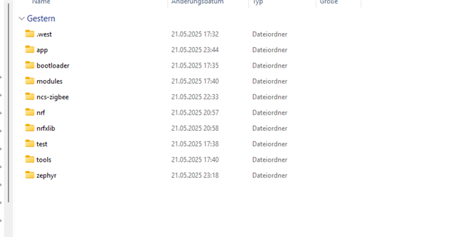

I try to migrate a working nRF53 Zigbee project from SDK 2.7 to the latest SDK and an nRF54. As described here, I also switched to Zigbee R23. The project structure is shown below.
But the build exit with the error message

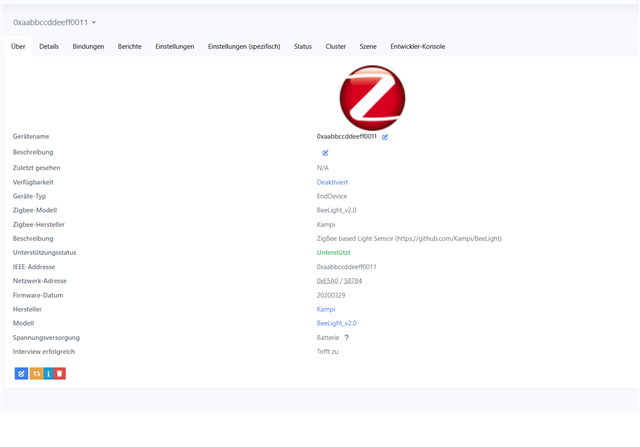

  • Hi
    I found the issue. I must add the install code to Zigbee2Mqtt, but for some reason I can´t add a 16 byte code (I did it wrong probably...). So I disabled the install code in the config
    # Enable channel 11 and 16
    channel_mask: 0x10800
    #install_code: 83FED3407A939723A5C639B26916D505
    extended_address: 86D79AC5BAE41FA3
    tx_power: 9
    app_data: 01ABCD
    Can you tell me what this means?
    app_data: 01ABCD
    Does this number has a specific function or is it a dummy from the template?
