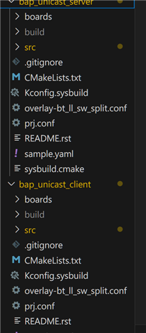

I have two nRF5340 DKs and want one to be server, one be client. I use NCS offcial code and simply buide them, however, "LED3 starts blinking green on every device to indicate the ongoing CPU activity on the application core" Both boards' LED3 is not blinky after I program the DK.
I am confused as "Building and programming using the nRF Connect for VS Code extension is currently not supported." Could you help me on this? I just want one board send out audio and one play it. Thank you so much!

    You are using the documentation for the nRF5340 Audio applications while building the Zephyr samples BAP Unicast Audio Client and Server. The Zephyr samples does not configure LED3 to indicate application core activity.
    The nRF5340 Audio applications use command line or a python script to build and program the applications. This is to ease programming of multiple kits with a single command.
    You can also build and program the application with the VS Code extension, though. I shared this method in another ticket a few months ago:  RE: Building Audio Broadcast SDK example in VS Code . I used the nRF5340 Audio Broadcast Source as an example back then, but let me know if you have any issues with using the nrF Connect for VS Code extension to build the nRF5340 Audio Unicast Client or Server applications.
