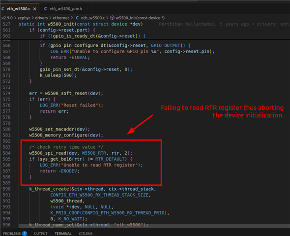

I have now been able to get the w5500 driver to initialize and I have verified the SPI interface is communicating correct via logic analyzer on the assocaited pins : MOSI, MISO, CS, SCLK, RST, INT.  That being said, It took me a while to get this working properly given the lack of documentation and examples, as I was getting a 'cannot read RTR register' error from the driver, but I did not know how to go about debugging this given the error had nothing to do with the code I wrote / application layer stuff. I ended up using a different breakout board (I ordered a pack of 3), and it just worked, leading me to think that either my pinout was incorrect, or that specific board was a dud / DOA (it is a cheap amazon board with no documentation etc.). Regardless, I think it would be very useful in the future to know how to dig deeper if driver code in the future isn't working, to perhaps help me narrow down what to troubleshoot.
Given the layer of abstraction introduced through the use of a driver in the devicetree, which is configured and initialized BEFORE main, I have been left wondering how I can go about setting break points and debugging code that exists outside of the application layer code I have written, particularly the stuff before main.

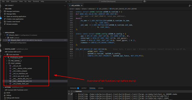

    If you're using our VS Code extension, you can more easily navigate the code included in the current build, including the initialization code that runs before main(). You are also free to place breakpoints in these init functions.
    E.g.,

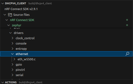

    Browsing for the ethernet driver in the SDK tree from the APPLICATIONS view:
