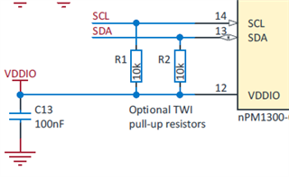

This sounds like a stupid question... but I would like to clarify if this pin is an input or output. I think it's power in but want to make 100% sure as I'm spinning a PCB.
The reference schematic shows just some decoupling caps and pullups to SDA/SCL, no other connections, which suggests it's an output.
But the datasheet text says link to VOUT which suggests it's an input.
The pin description just says "POWER".
Can you clarify please?
