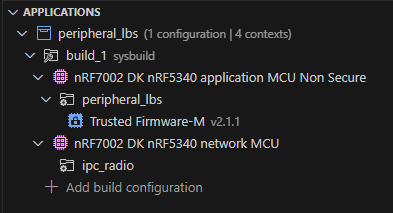

I'm guessing this example has to load code to both the App and Network cores, but I don't know.

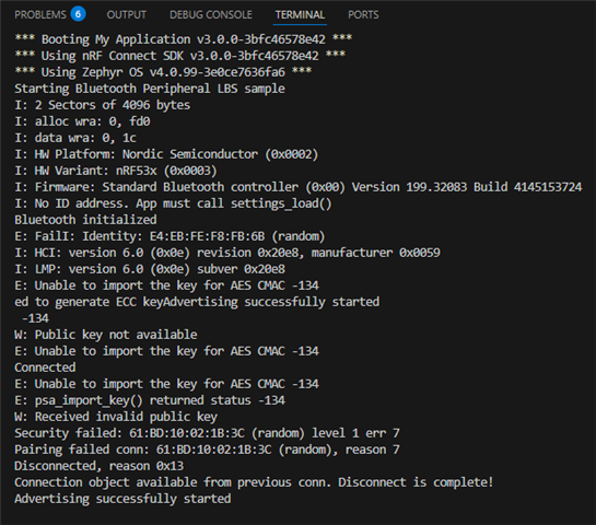

I've tried setting it to nrf7002dk/nrf5340/cpuapp/ns.

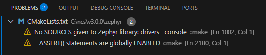

When I do, a clean build generates the following build warnings.
Both cores are listed under the build config. The course does not instruct as to how I specifically flash both cores. Do I just select the "build" folder level then Flash under Actions and that automatically flashes both cores? That is my presumption.

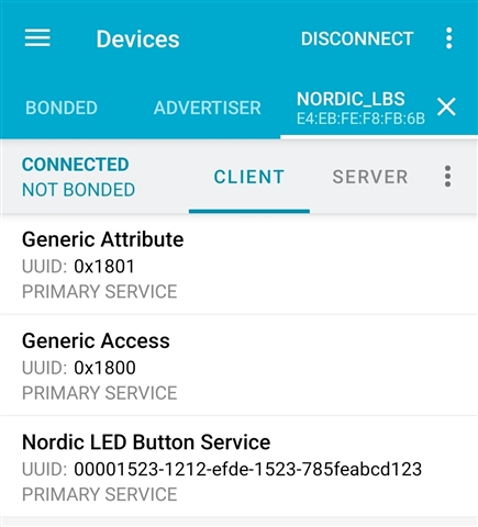

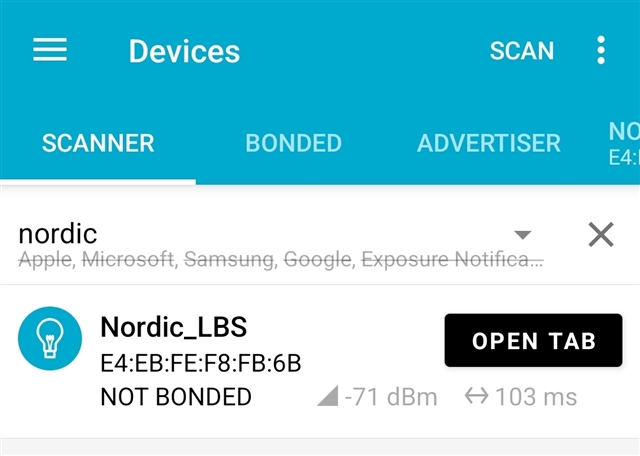

When I do this... it seems like the flash worked as LED2 is flashing as expected, but I cannot bond to the nRF Connect server (Android).
It seems to be failing on invalid public key.

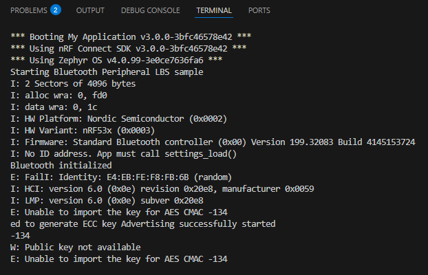

  • Hi Simon... here's some more data. I have attached main.c as well.
    I am using the LBS sample. Build configuration:
    Trace...
    nRF Connect...
    Main.c attached...
