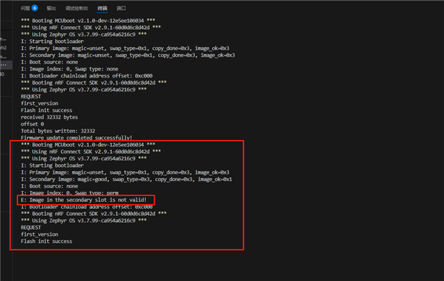

However, the update failed continuously. This is the error log reported by mcuboot.
its display secondary slot is not vaild,then I dump flash data

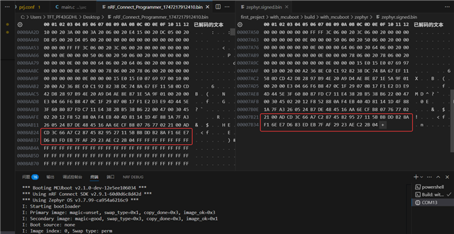

In Flash, the corresponding address contains the content I wrote, and the size and other details are also correct. Then, the part circled in red at the top should be the check bit of the swap_type located at the end of the secondary slot sector.
The specific content and the address where it is located have also been confirmed to be correct.
However, it was never able to be upgraded. Later, after debugging, it was found that the program failed during the hash verification process. it should be the verification of the TLV field. It is located at the end of the image, which is the part circled in the above picture.
Here's the problem: even though the contents in the flash are identical to the zephyr.signed.bin file, the upgrade still fails. Later, I dumped a Zephyr routine that can be upgraded successfully and checked the flash status before upgrading. I found that the TLV fields at the end of this routine's flash are different from the last 69 bytes of the zephyr.signed.bin in this routine.
I have found in many official and unofficial documents that this zephyr.signed.bin is used for DFU/OTA upgrades, and apart from this file, I haven't found any other new files that seem suitable for upgrading.
Then the remaining possibility is that since Zephyr uses west flash for burning, could it be that west flash modifies the signature? Or there might be other issues? What should I do next?

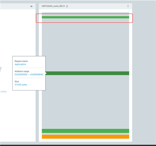

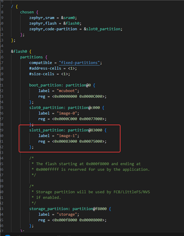

  • thanks for your reply,I've double-checked the address offset I set for Slot 1, and it exactly matches the flash addresses I dumped earlier.
    after my verification, in my code, both the size and offset in the flash are correct. On the contrary, in the successfully upgradeable routine, the TLV fields at the end of the image cannot match those of the zephyr.signed.bin. I am very curious about this issue,and it maybe the key of the question?
    If the partition manager is used (which is the default for nRF Connect SDK), the partition in the devicetree is not used. So it would be good to check the partition manager report. Can you generate the partition report as described here and share it?
    What is the difference between the two image trailers you list? Are they from the exact same image, or is there a difference (could be just a different build time, if the time is included in the imsage as is the case with the SMP server sample, or any other change that would cause it to difer).
  • Dear Engineer Sir
    hello
    I have posted two trailer images: one is the actual data I dumped from the flash, and the other is the compiled zephyr.signed.bin firmware binary. This should confirm that the real data in the flash matches exactly what I wrote, proving that my program works correctly. However, when I dumped a functional (successfully upgradable) example project, I discovered that the real data in the flash differs from the trailer section at the end of the compiled zephyr.signed.bin file. I have been unable to resolve this issue, and through debugging, I found that the program fails specifically in the trailer verification function。
    "Additionally, the device tree partitions in my setup align perfectly with the actual hardware partitions. Please review this memory layout diagram I’ve provided—it should serve as conclusive evidence.

    Then I built first version (with the printf saying "first_version") and flashed that. Then modified the printf, rebuilt the firmware and generated a hex file of the signed bin file that has the offset for slot 1 like this:
    $ bin2hex.py --offset=0x83000 build/serial_for_mcuboot/zephyr/zephyr.signed.bin build/serial_for_mcuboot/zephyr/zephyr.signed.offset.hex
    Then I programmed that file using nrfjprog, to write it to slot 1:
    nrfjprog --program build/serial_for_mcuboot/zephyr/zephyr.signed.offset.hex --verify
    The I pressed button 1 to call boot_request_upgrade(), and observed in the log that the new image was activated as it should:
    *** Booting MCUboot v2.1.0-dev-12e5ee106034 ***
    *** Using nRF Connect SDK v2.9.1-60d0d6c8d42d ***
    *** Using Zephyr OS v3.7.99-ca954a6216c9 ***
    I: Starting bootloader
    I: Primary image: magic=unset, swap_type=0x1, copy_done=0x3, image_ok=0x3
    I: Secondary image: magic=unset, swap_type=0x1, copy_done=0x3, image_ok=0x3
    I: Boot source: none
    I: Image index: 0, Swap type: none
    I: Bootloader chainload address offset: 0xc000
    *** Booting nRF Connect SDK v2.9.1-60d0d6c8d42d ***
    REQUEST
    first_version
    Set up button at gpio@50000000 pin 11
    Flash init success
    Button pressed. Requesting upgrade... (new image must allready be copied into slot 1)
    I: Secondary image: magic=good, swap_type=0x3, copy_done=0x3, image_ok=0x1
    I: Image index: 0, Swap type: perm
    I: Starting swap using move algorithm.
    REQUEST
    second_version
    Flash init success
    This tests your whole approach, except the part where you copy the data via UART, so unless you used the wrong image file to test with (?), this is where the problem must be and that should be looked at more closely.
