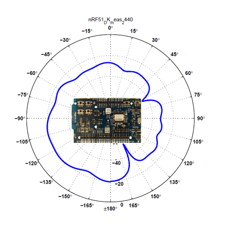

  • The orientation of the antenna will effect the results as the antenna does not hav uniform gain in all directions.
    1. I would like to inquire if there is an antenna pattern for the nRF54L15DK PCB.
    You are looking for the antenna gain ? or are you looking for the physicals shape of the antenna?
    - we dont have measurements from the L15 DK but we do have from som older DKs and the antenna is the same so it should be similar.
     antenna_meas.zip
    Unfortunately we only have the radiation pattern for the plane of the PCB (XY) plane, the DK was rotated and measured while laying flat. We therefore do not have any radiation pattern in the Z (upwards/downwards) direction, I hope it still can be of some use for you.
    The reference level(outer circle) is 0 dBm, and there is a 20 dB/div (in all plots I think).

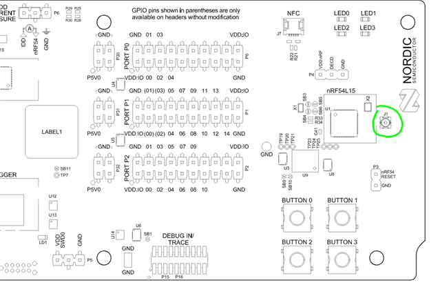

    You could use a external antenna here if you wish with the connector on the RF path.
    Jonathan
  • Hello, I'm very interested in the external antenna you mentioned. When performing one-to-many ranging using channel sounding, antenna issues often prevent data collection from some devices, leading to positioning failures. I'd like to install an external antenna to solve this problem. Could you please tell me the specific location of the RF path? Does it require soldering?
  • Hi, on the DK we have a connector in the RF path that can be used to connect an external antenna with the right adapters.
    J1 on the DK's can be used for this.
