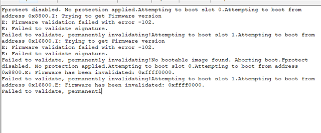

    Fprotect disabled. No protection applied.Attempting to boot slot 0.Attempting to boot from address 0x8800.I: Trying to get Firmware version
    E: Firmware validation failed with error -102.
    E: Failed to validate signature.
    Failed to validate, permanently invalidating!Attempting to boot slot 1.Attempting to boot from address 0x16800.I: Trying to get Firmware version
    Failed to validate, permanently invalidating!No bootable image found. Aborting boot.Fprotect disabled. No protection applied.Attempting to boot slot 0.Attempting to boot from address 0x8800.E: Firmware has been invalidated: 0xffff0000.
    Failed to validate, permanently invalidating!Attempting to boot slot 1.Attempting to boot from address 0x16800.E: Firmware has been invalidated: 0xffff0000.

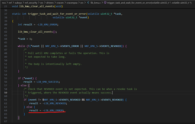

    I further debug the scenario and found one area from where I am getting "E: Firmware validation failed with error -102.",
    Actually, due to LIB_KMU_ERROR verification is failing.
    Below is the call flow
    bl_validate_firmware_local->validate_firmware->validate_signature->root_of_trust_verify->verify_signature->bl_ed25519_validate->
    psa_verify_message->get_key_buffer->cracen_kmu_get_key_slot->get_kmu_slot_id_and_metadata->read_primary_slot_metadata()
    Now, not sure why I am getting the error with this. If you can suggest anything on this will be a great help.
