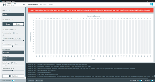

Hi
I connected RF Connect for Desktop to "nRF54L15_DK" in my Desktop
when I want to use Direct Test Mode,press Start test bottom,the log show "DTM setup reset command failed"
how can i fix it?

Which SDK version of DTM did you flash to your device?
When flashing DTM to your nRF54L15-DK, it will present you with two COM ports. Could you check the second COM port in the top-left corner and see if this works?

Have you flashed any firmware to your nRF54L15-DK?
The device must be loaded with the direct_test_mode firmware for this to work.

i think that is key point...
how can i flash firmware?
Here's dtm for the nRF54L15-DK from NCS v2.9.1:
You can use the programmer app in nrf connect for desktop to program your board. just point (or drag-and-drop) to this file and write it to your board.
Håkon
OK! the tool is working now,
