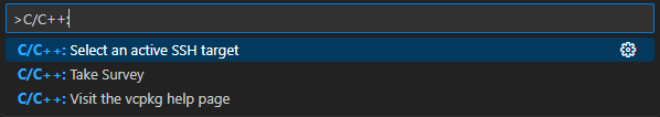

    Could you try to Ctrl+Shift+P and select "Developer : Show Running Extensions " and see if you have only C/C++ running and nothing of STM?
    If so, you could try Ctrl+Shift+P and select "C/C++ : Reset IntelliSense Database".
    Please try this and let me know how it goes.
    Priyanka
  • Hi Priyanka,
    nothing from STM running, C/C++ from Microsoft is running. Although, I do not have the option to reset the Intellisense database, it is missing from the list...

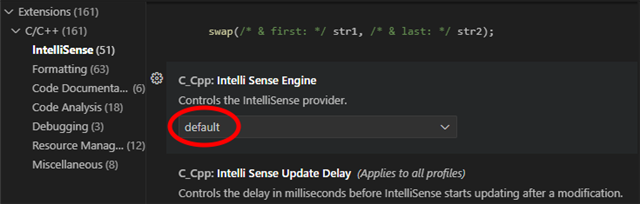

  • I think I found the problem:
    Go to the Extensions view, select C/C++ and on the gear symbol ('Manage') next to the Auto-Update checkbox, select "Settings". Then, select "IntelliSense" and scroll down almost to the bottom to the "Intelli Sense Engine" setting. In my case, it was disabled. I set it back to "default" and now the code analysis is running again.
    It is a bit annoying that this important setting is hidden so deep in the configuration, and it is annoying that it is not reset to default even if I remove the C/C++ extension and re-install it again. And it makes me sad that extensions from different conpanies might side-stab the settings of another company because there are compatibility issues with extensions.
    But enough with the complaints. Maybe my findings can help other developers that are expected to work with both Nordic and STM hardware to re-enable their code analysis under C/C++ Nerd
