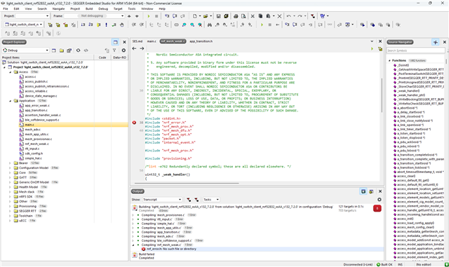

But i facing issue in setup and specifically flash code in my board. see in nrfsdkformesh in that i open the basic light switch example in the folder there are client and server file both files accessible for embedded studio, and in that when i build file, it give me error because the main.c file in application folder.

here i attach my embedded studio screen shot.

    If you have not moved around any of the files or folders in the SDK, the reason SES fails is probably one of the two:
    1: The path is too long. Try unzipping the SDK in a location closer to C:\ . This is a compiler issue in Windows. The max length of the path length can't be longer than 250 characters.
    2: It is looking for a file in the "normal" SDK. So if you are using nrf5 SDK for mesh v5.0.0, you need a normal nRF5_SDK_17.0.2_d674dde located in the same folder as your nrf5_sdk_for_mesh_v5.0.0_src.

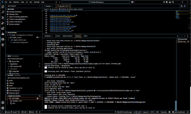

  • thanks for replay Edvin,
    here i follow all steps for setup and successfully able to build mesh sample code, but every time facing issue in flashing process, and the issue is fatal error.
    I try every type in build configuration i try mdk, kbd, dk of my nrf52832. still facing same issue.

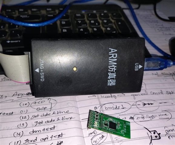

    And what kind of debugger are you trying to use? Is it an external standalone debugger (if so, what type)? I don't recognize the serial number from our DKs.
    I am using ARM v9 J-link debugger (JTAG+SWD) ISBN: WZL970X
    here i attach my debugger and custom board pic;

    I see. So the board you are using are trying to use pyocd, which is openOCD, and this is not supported by us. I wouldn't recommend using this for a production grade product, but according to the log, you seem to be missing libusb. See if you can install that, and whether you will be able to flash.
    I recommend that you get hold of an official Segger JLink debugger.
    Alternatively, for testing, if you have a DK, you can use this for debugging. Our DKs have an on board debugger, and you can use this to program external boards as well.
    If you want to go down the OpenOCD path, which is open source, you can try that, but it is not something we support.
