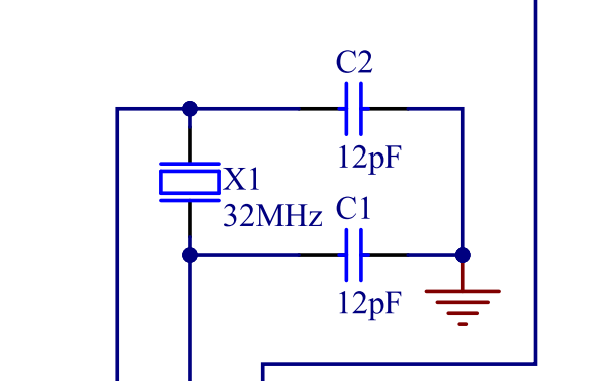

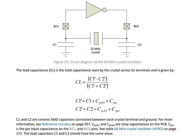

nrf52840 HFXO PCB Stray Capacitance
I am currently designing with the nrf52840 and trying to implement the 32 MHz crystal required for bluetooth radio operation. The calculations for the load capacitance given on your datasheet on page 159 have left me a bit confused. What is meant by the PCB stray capacitance and how can we calculate this? No help is given at all in the datasheet for what this means or how to calculate it.
