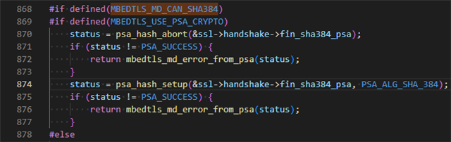

On nRF9151, how to deactivate SHA384 support in MBEDTLS when MBEDTLS_USE_PSA_CRYPTO is active ?
I'm trying to use MBEDTLS with MBEDTLS_USE_PSA_CRYPTO and CONFIG_PSA_CRYPTO_DRIVER_CC3XX activated.
Unfortunately I can't find a way to tell MBEDTLS that nRF9151 is not supporting SHA384.
When I execute mbedtls_ssl_setup(), psa_hash_setup() in ssl_tls.c always fails because the define MBEDTLS_MD_CAN_SHA384 is always activated
I tried to unset it in my project.conf by different way but nothing works :
- CONFIG_PSA_WANT_ALG_SHA_384=n (that willl be in the future the good way to do it  but not supported yet even with SDK 3.0.1 - commit https://github.com/Mbed-TLS/mbedtls/pull/9171/commits still in development branche )
- CONFIG_MBEDTLS_MD_CAN_SHA384=n or CONFIG_MBEDTLS_SHA384_ALT=n => "error: ... is not directly user-configurable (has no prompt)"
- trying to set a custom config.h for MBEDTLS => warning: MBEDTLS_CFG_FILE (defined at .../v2.9.0/nrf/subsys/nrf_security/Kconfig:66, modules/mbedtls/Kconfig:58, modules/mbedtls/Kconfig:58) was assigned the value 'myconfig.h' but got the value 'nrf-config.h')

  • In your SDK it seems this config is the culprit for force enabling all SHA algorithms:
    config MBEDTLS_TLS_VERSION_1_2
    	bool "Enable support for TLS 1.2 (DTLS 1.2)"
    	select PSA_WANT_ALG_SHA_1
    	select PSA_WANT_ALG_SHA_224
    	select PSA_WANT_ALG_SHA_256
    	select PSA_WANT_ALG_SHA_384
    	select PSA_WANT_ALG_SHA_512
    	select MBEDTLS_CIPHER
    I was able to disable unwanted SHA algorithms by adding:
    CONFIG_MBEDTLS_TLS_VERSION_1_2=n
    In addition, set all of Legacy and PSA Crypto SHA kconfigs for good measure, e.g.
    CONFIG_MBEDTLS_SHA384_C=n
    You may need to enable other Kconfigs if you were depending on the above Kconfig to enable them (search your SDK for references to MBEDTLS_TLS_VERSION_1_2), Disabling it was surprisingly unimpactful for my own project, I did not need to worry about explicitly enabling any defines I hadn't already. One of general interest might be MBEDTLS_SSL_PROTO_TLS1_2 but it stays enabled in my project without explicitly enabling it.
