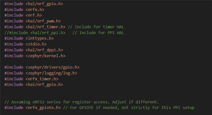

Hello everyone,
I am a EE student and this problem came up during my first big project in zephyr. I'm trying to connect a pwm peripheral (pwm1) to the timer 2 hardware timer in zephyr. The idea is to have the timer in the counter mode and have it increment every rising edge of the pwm signal generated by the pwm0 peripheral (on the peripheral itself, I'm using all 4 channels and I'm generating identical signals on all 4 - 102.4 kHz pwm that serves as a clock input to a different sensor component). After 15360 cycles of pwm signal, the timer is supposed to fire and execute a callback function.
In this code (it's just some testing code) I also try to toggle a led every time the timer time passes.  I tried using nrf_ppi.h but it didn't work since in the lines:

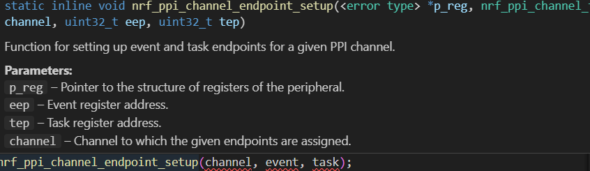

nrf_ppi_channel_endpoint_setup();
nrf_ppi_channel_enable();
I would have to use to actually connect the peripherals via PPI I would have to use the following arguments:
and in some online example (there is almost none) I found that for the *p_reg argument one is supposed to use NRF_PPI that is supposed to be defined in the library but for me it wasn't. Hence, I switched to dppi and it at least built. These are my includes:

This is my main with the pwm bare metal generation first (this I probed and it is truly generated) followed by the timer2 setup and ppi connecting as well as some printing for debugging.

    // --- Timer 2 Initialization for Counting ---
    NRF_TIMER2->MODE = NRF_TIMER_MODE_COUNTER; // Configure as counter
    NRF_TIMER2->BITMODE = NRF_TIMER_BIT_WIDTH_32; // Use 32-bit counter for large counts
    NRF_TIMER2->PRESCALER = 0; // No prescaling, each PPI event counts as 1
    NRF_TIMER2->CC[0] = PWM_COUNT_THRESHOLD; // Set compare value
    NRF_TIMER2->INTENSET = NRF_TIMER_INT_COMPARE0_MASK;
    // Clear the timer before starting
    NRF_TIMER2->TASKS_CLEAR = 1;
    NRF_TIMER2->TASKS_START = 1;
    IRQ_DIRECT_CONNECT(TIMER2_IRQn, 0, timer2_irq_handler, 0);
    irq_enable(TIMER2_IRQn);
    NRF_DPPI_ENDPOINT_SETUP((uint32_t)&NRF_PWM1->EVENTS_SEQEND[0], DPPI_CH);
    NRF_DPPI_ENDPOINT_SETUP((uint32_t)&NRF_TIMER2->TASKS_COUNT, DPPI_CH);
    // 2. Enable the channel
    nrf_dppi_channels_enable(NRF_DPPIC, (1 << DPPI_CH));
    printf("PWM1 and PWM0 starting...\n");
    NRF_PWM1->TASKS_SEQSTART[0] = 1;
    NRF_PWM0->TASKS_SEQSTART[0] = 1;
    printf("PWM cycle counter set up for %d cycles.\n", PWM_COUNT_THRESHOLD);

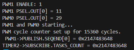

    uint32_t pub_reg = *((uint32_t *) ((uint32_t)&NRF_PWM1->EVENTS_SEQEND[0] + 0x80));
    uint32_t sub_reg = *((uint32_t *) ((uint32_t)&NRF_TIMER2->TASKS_COUNT + 0x80));
    printf(" PWM1->PUBLISH.SEQEND[0] = 0x%u\n", pub_reg);
    printf("TIMER2->SUBSCRIBE.TASKS_COUNT = 0x%u\n", sub_reg);

When checking the registers sub and pub I get this as my printing statement outputs
Since the pub and sub registers aren't zero it makes me believe that ppi is connected properly but the counter doesn't really count up. The statement TIMER2 live count: 0 keeps printing out and I cannot get the timer to start counting up, hence the callback never executes.
