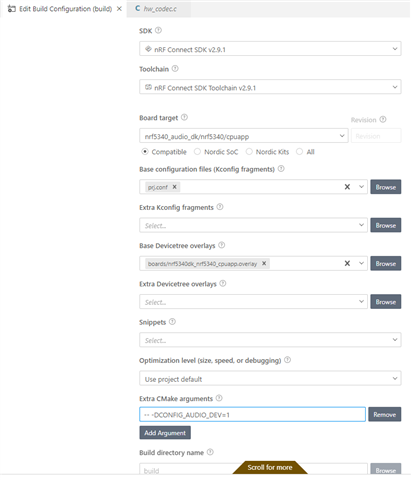

  • Can you help me get my build configuration set up? If I use "Create a new application" to copy the audio application to a local folder and try to set up a build configuration for it I can't get it to compile. Here's what I've got now but I'm clearly missing something.

  • Hi Glen,
    Regarding compilation problem, can you check if building is successful when you build audio application with added only Extra Kconfig Fragments boards\nrf5340_audio_dk_nrf5340_cpuapp.conf?
    In the default setting, the BIS receiver is working like a pair of TWS earbuds.
    The log shows it is left earbud, which output the left channel.
    If you check the log from the broadcaster side, then you would see the broadcaster broadcasting both L and R, from different BISes, each BIS contains one channel, with 120 bytes payload.
    For BIS stereo receiver, you can look at this unofficial demo sample which is provided as-is, for testing purposes, without any warranty or guarantee to be working.
